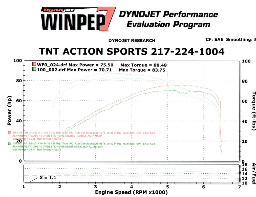

Ok here we go. This is the dyno on my 2014 twin cool Tri Glide yesterday.
Nightstick slip ons, Stage one se air cleaner, SE race tuner and no cat. I can tell ya this trike out preforms the Road Glide I had hands down.
I am impressed minimum money great power and no warranty issues
