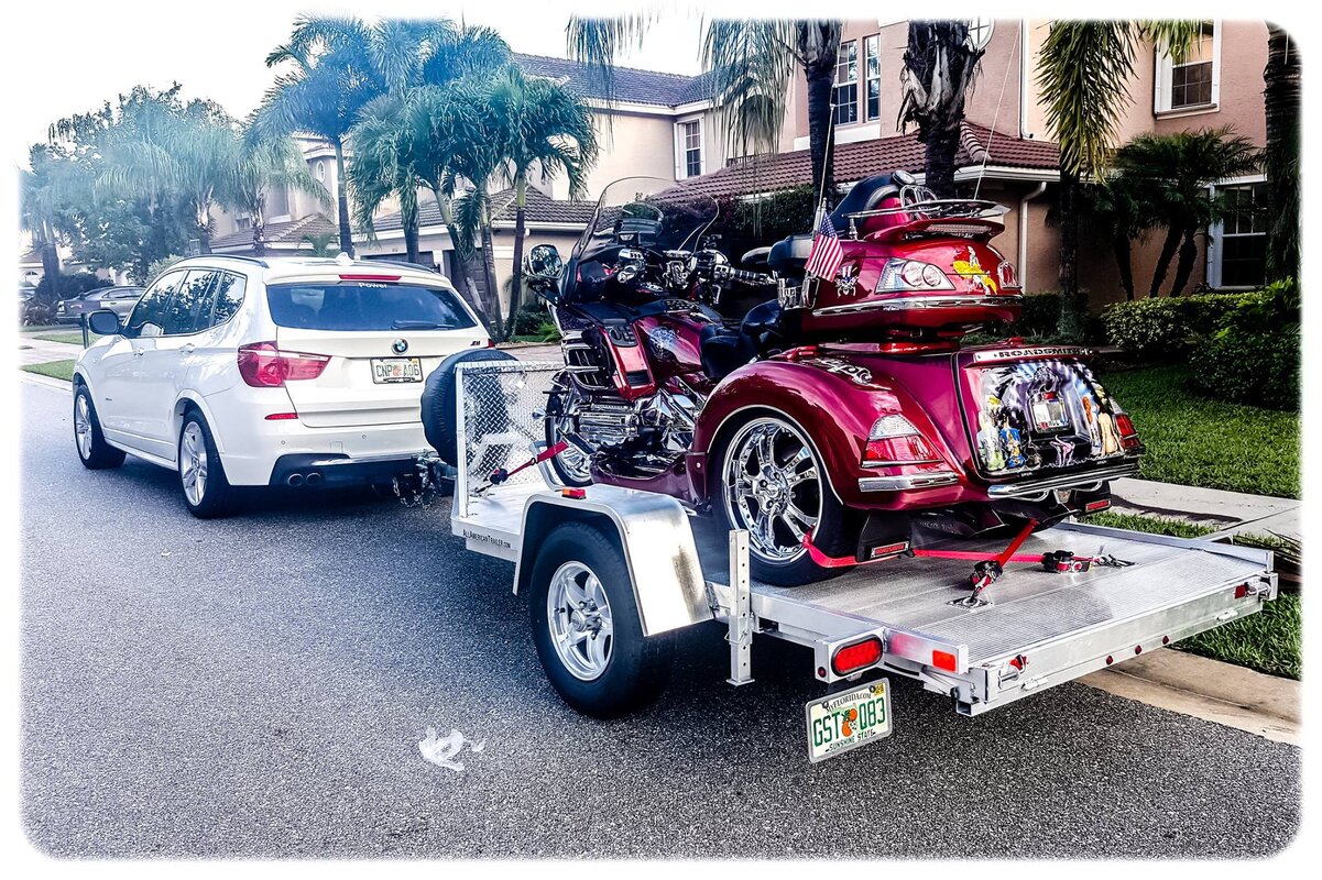

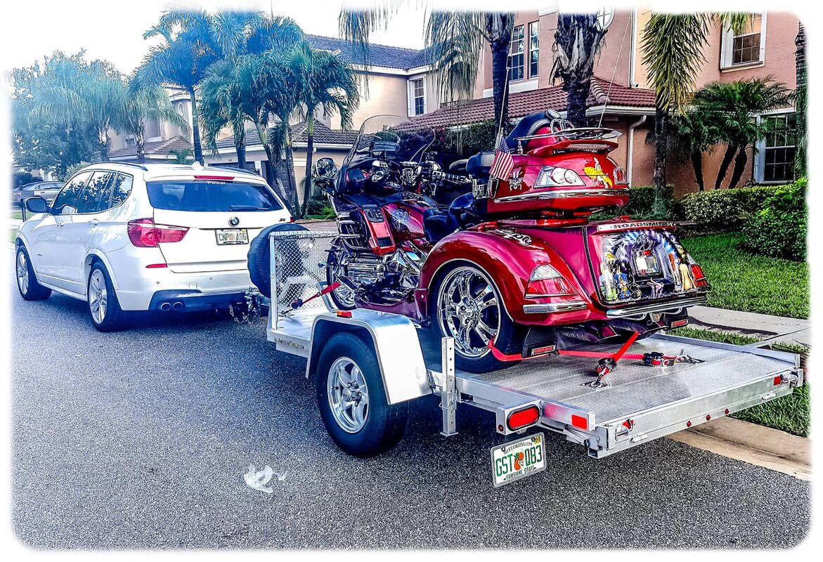

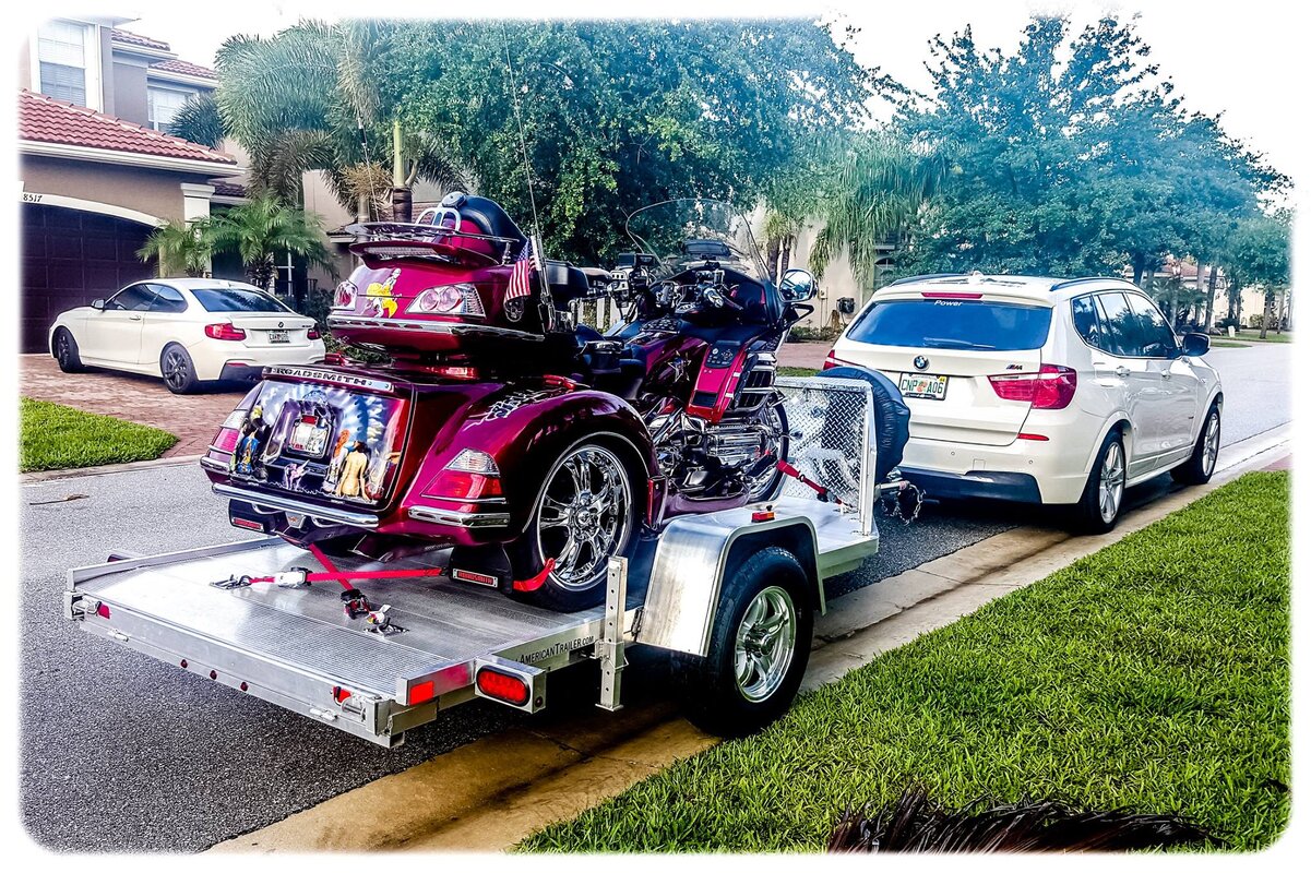

Herst, this is exactly the setup I have and love it. Just did a trip with over 1500 miles towing and 1300+ riding!!! I use soft loop tie-down straps and retractable ratcheting tie-downs upfront on each side from the engine guards to the front recessed tie rings and 2 in the back, where I use two soft loop tie-down straps tied together thru the rear wheel and criss-cross my retractable ratcheting tie-downs to the rear recessed tie rings. Parking break on and tow away :laugh:
Here are the links for you:

13320537_10205728952134111_1595230749993051709_o.jpg13301471_10205728952094110_7223690250430500293_o.jpg13308665_10205728959894305_4435825500937921271_o.jpg
Alternative Tie-Down Method
Michael, I would not suggest using any tie-downs on the front engine guards or the saddlebag guards. These guards are limited by the "shear" limits of the attachment bolts.
I sheared off one of the guards while transporting on a long trip. As an alternative, I have had great success with placing a couple of soft ties around the lower triple tree. Then I attach a couple of ratchet straps making sure the straps will not rub the tupperware while in transit.
I spoke with Traxxion about the slight constant compression on the front shocks during transport. They indicated that there is no problem with this set up. As an added precaution, I stuff a small rolled up towel between the fork brace and lower triple in case of rough roads to keep the front end from totally compressing.
I have been using this method for years now without snapping off another engine or saddlebag guard.ThumbUp

Is your wheel chock located as far forward as possible?
