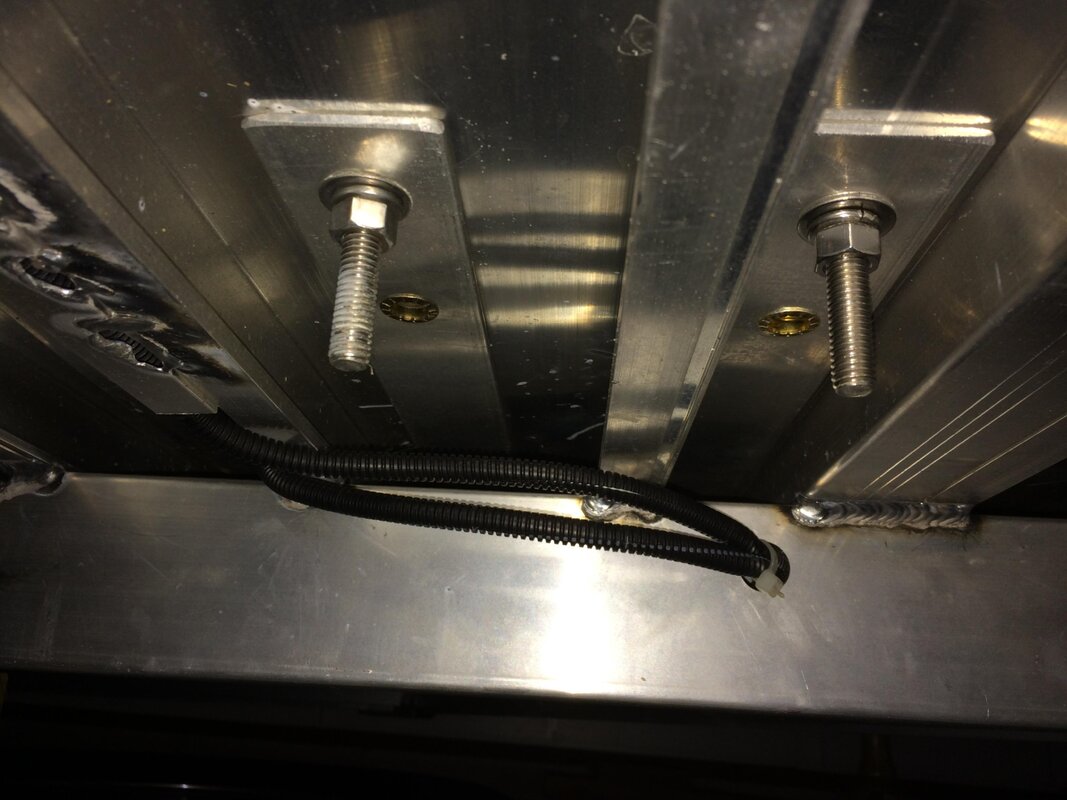

No, the bolts are going between the I-beam cross member spans through the deck material. Do not drill through the cross member spans. If you are using the wheel stop(chock) provided by Aluma, the kit comes with about 1.5" wide steel backing plate strips used to stiffen the deck material.
This will all make more sense after looking at my bolt connection picture below. The picture was taken looking from the right side of the trailer:

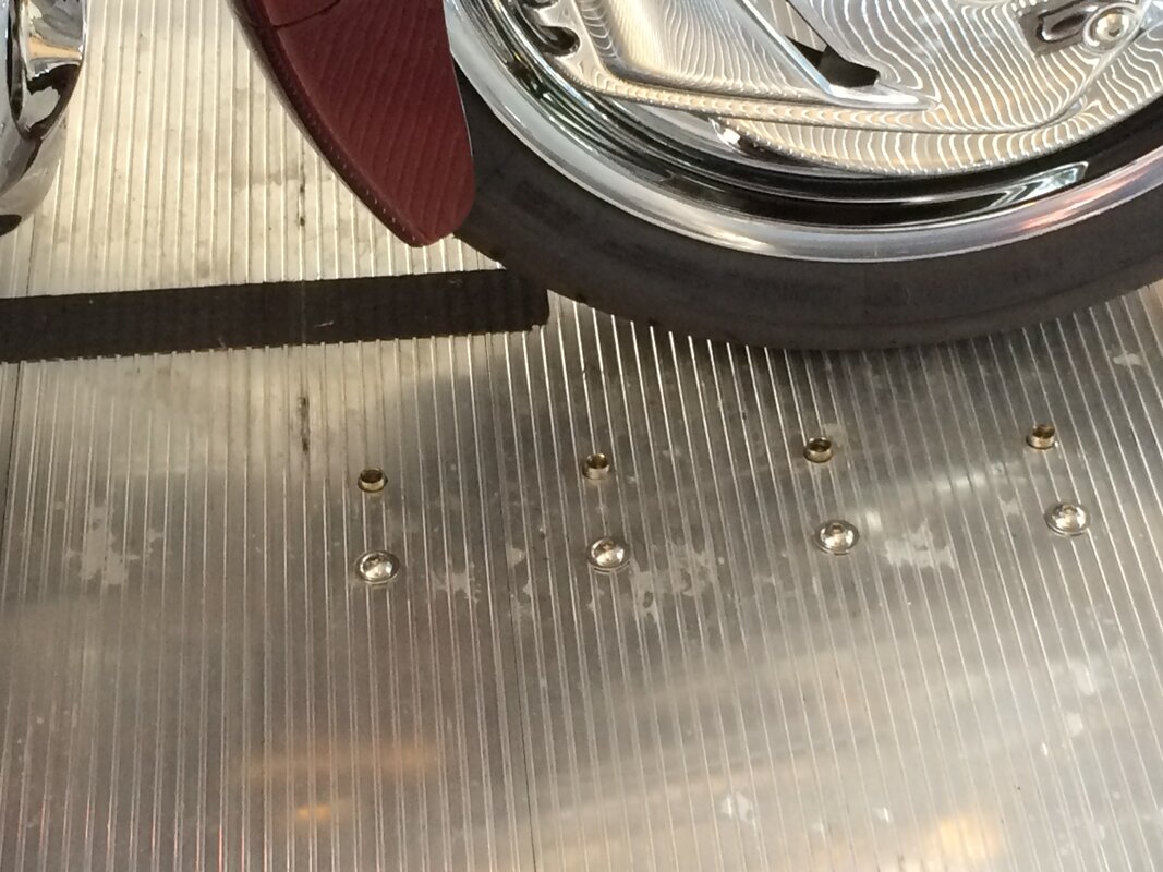

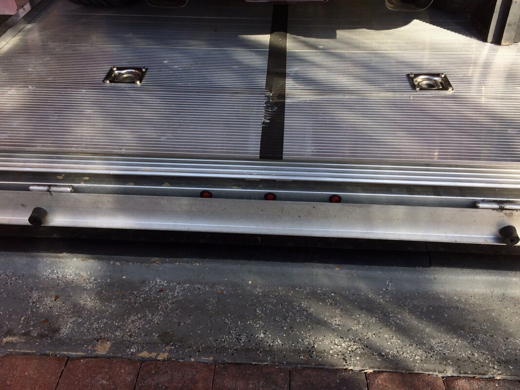

I attached 2"' wide strip of 3M non-slip sidewalk tape available from the big box stores. I ran this strip almost the entire length of the center line of the deck. I found it helpful in lining up the trike and keeping the trike centered while loading. The only thing I would recommend would be to use the wider tape which is about 4" instead of the 2". Proper cleaning and preparation before application of the tape is a must.

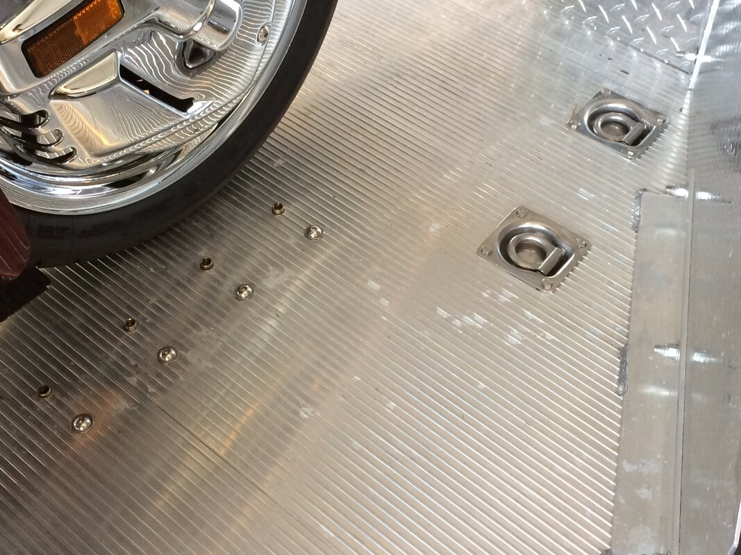

As I have already mentioned in a previous post, I relocated the wheel stop back one step (4 3/8")to the next full span of cross beams. I now have two locations to quickly mount the factory furnished wheel stop. One location yields about 285# of tongue weight. The other location yields about 210# of tongue weight. If I ever change out tow vehicles, I have the option to use either tongue weight. You can also see the other end of the 3M non-slip guide tape.
This is another photo of the wheel stop bolt hole patterns with the wheel stop removed. I also had installed, from the factory, 2 extra recessed tie downs place about 10" back and about 1" wider than the 2 front stock recessed tie downs. The extra tie downs have really come in handy and work especially well for the Goldwing setup.

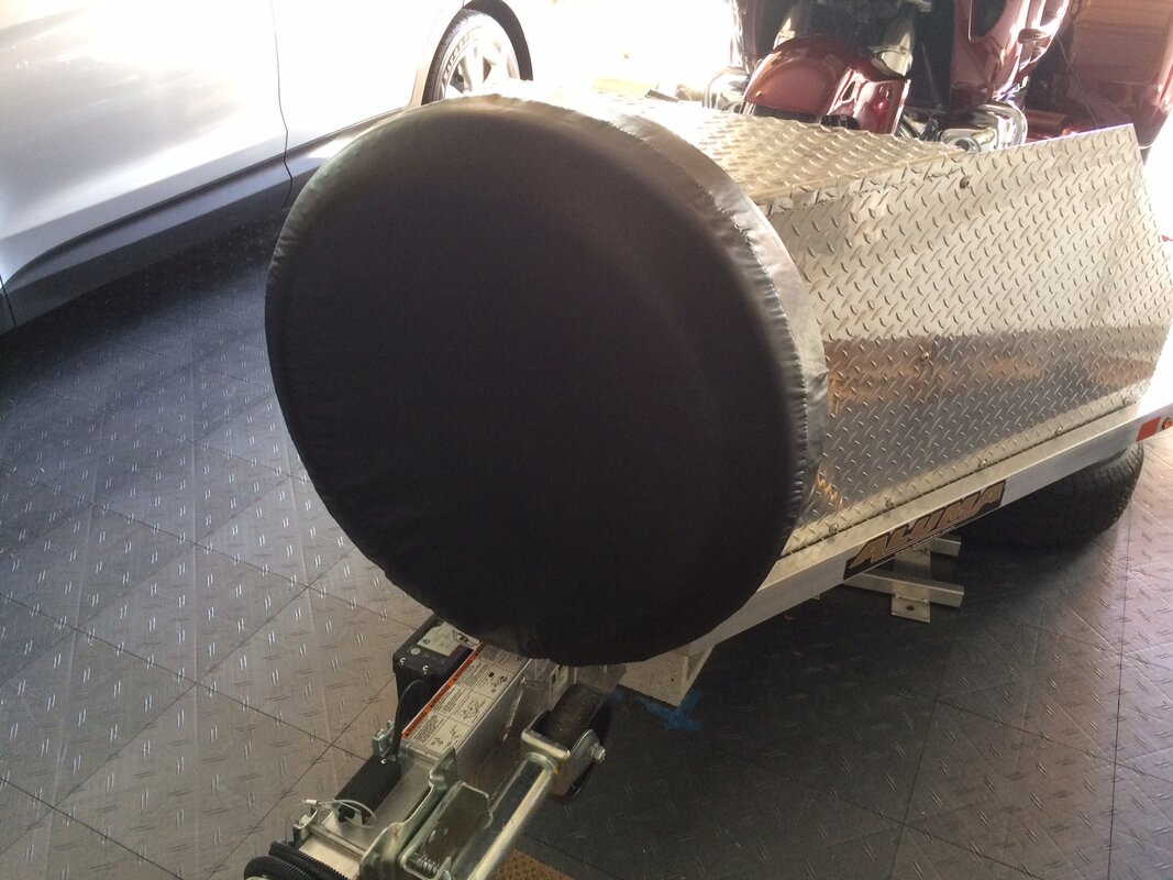

I had a tongue mounted spare tire included with the purchase. This has turned out to be a real good use of space too. The wheel jack folds out of the way.
