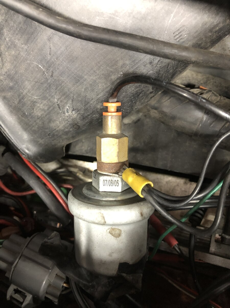

On mine, this device ensures that I have 20# of pressure at all times. You will hear the compressor turn on when first turning on the ignition when the bike has been parked. (There is a possibility that the air line going in the top is pinched, looking at that pic. Has definitely been kinked!! )
The line is connected via a push to connect air line fitting. Of course, there is a tool for them, but other tools work.
With a small open end wrench, like 1/4", press the top of the orange fitting down. With the other hand, pull the line out.
Depending on how long the o ring inside and the line have been together, might need a firm tug. Usually not a bunch of force needed.
