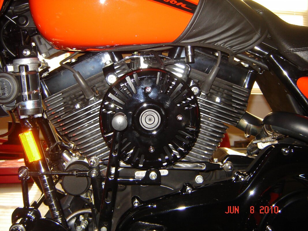

I Purchased a Wolo Air Horn from Harbor Freight less than $30.00 with discount. Installed at location of Cowbell horn. Sounded great But, it didn't last long. I rode from West Paducah Ky. to Key West Florida every thing was fine . As I was coming back I heard some vibration and the Horn wouldn't work All the engine vibration shook it apart . Exchanged it, remounted it under seat area. These are great horns for sound For the price. This one should last no vibration in new location.
Wouldn't recommend installing one in cowbell location this was black plain jane model The chrome one may be built better to withstand all the vibration from the engine but they cost a lot more and has the same model # so I dout it will last.
