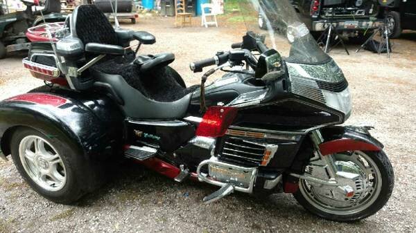

I'll try to post a photo of the trike I hope proves to be as good as it looks and is described.

Sweet looking ride. Hopefully the many within this forum who have an astronomical upper level of experience over me will provide information on any quirks the 91 may or may not have. Sorry I couldn't be more helpful.

Regards the 'Wing, there was an issue with *some* '90-'96 models, with the 4th gear shifting fork, causes the bike to jump out of 4th or 5th gear. Out of the 11 GL1500's I've owned, I've seen it in two (that I didn't buy)
The quick test for this, after the bike is warmed up, nose it downhill... put the steering tire in a low spot... the chirping, tapping will show up then, as the free hanging fork slides into the gear while idling in neutral. Many times, it only occurs then if not too worn. If really worn, it will probably tap/chirp at idle, in gear or not, in all positions.
This problem happens in a low percentage of GW's, but is expensive to fix if it happens to you. Test ride it, don't expect it to chatter, most don't, just be aware. I love the 1500's, ergonomics were better for a taller rider & power was adequate.
Of yeah, what it sounds like...
