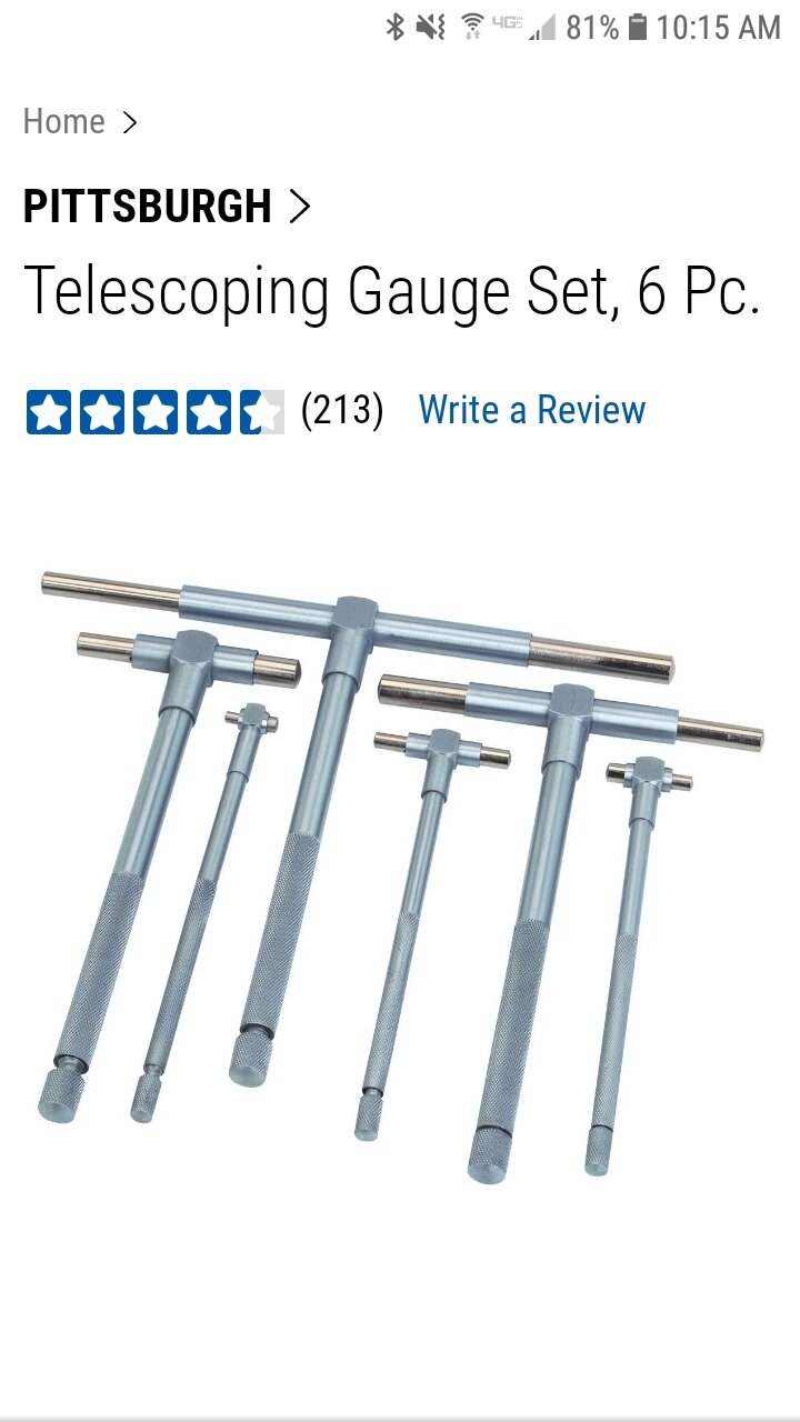

I adjusted my drive belt this morning. It's quite easy. For those who might have a hard time getting the precise adjustment, this is what I use.And with a micrometer I can get it within a couple of thou. I measured just to the inside of the adjustment screw. I'm on the side to think the factory specs are a little tight so I set it at half an inch.
