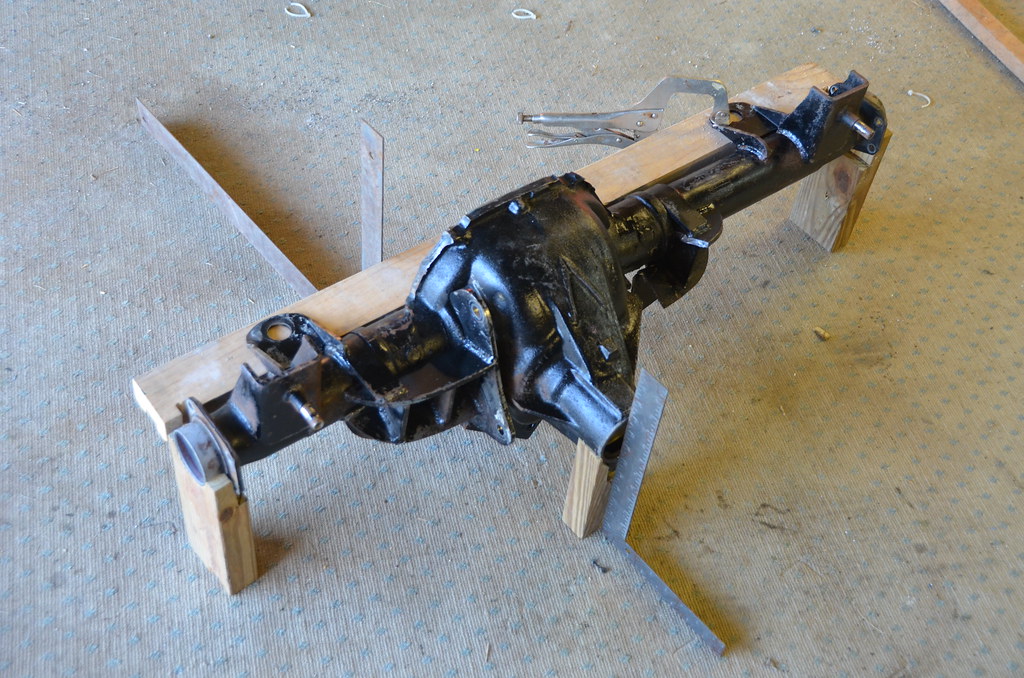

I have a 2006 Motortrike, and the airbag mounts couldnt be simpler - hole in a flat plate. bent at the edges, then fishmouthed to fit the axle tube. Not even a 'keyed' or indexed alignment to the bag, the hole was 1/2" and the bolt 5/16"
The axle is shown upside down, the brackets are pointing to the left, one has the vise-grip attached.
