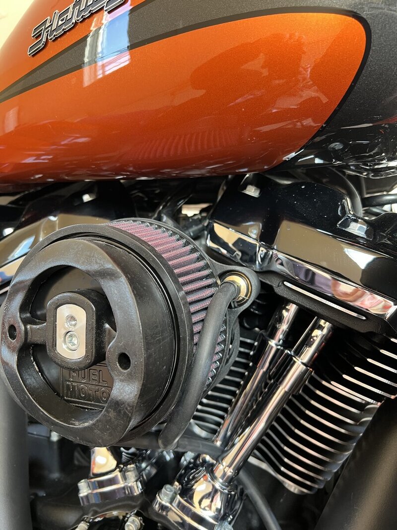

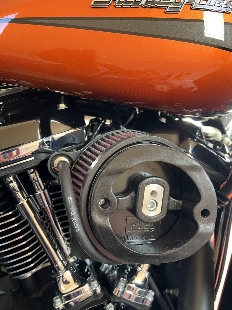

My project yesterday was to reroute the breather vents in the head so I’m not coating the throttle body and intake with oil.
I have a Fuelmoto AC/DC air cleaner kit with adapter to reuse the factory cover. I reinstalled the factory breather bolts that has the hose nipples on them and used Gates brand 1/4” vacuum/evap hose with a “Y” connector.
Instead of a catch can, routed it down with the radiator overflow tube and will just let it drip like the crankcase vents on my tractors and semis do.

Pretty slick there.I like
