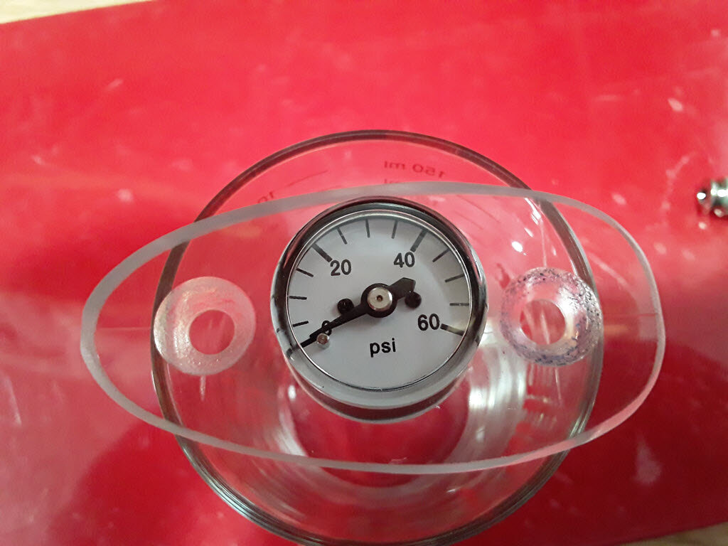

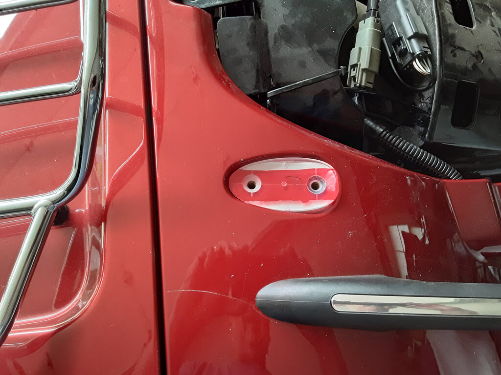

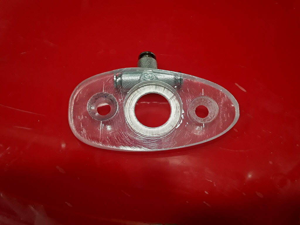

We've had the Freewheeler in the family since 2018 and I've always found it annoying to have to pull the side cover to check the air pressure for the rear shocks. This belongs to my wife and is always ridden solo and we have no accessories screwed into the location I used. I started by roughing out a plate using Lexan.1_Blank.jpg

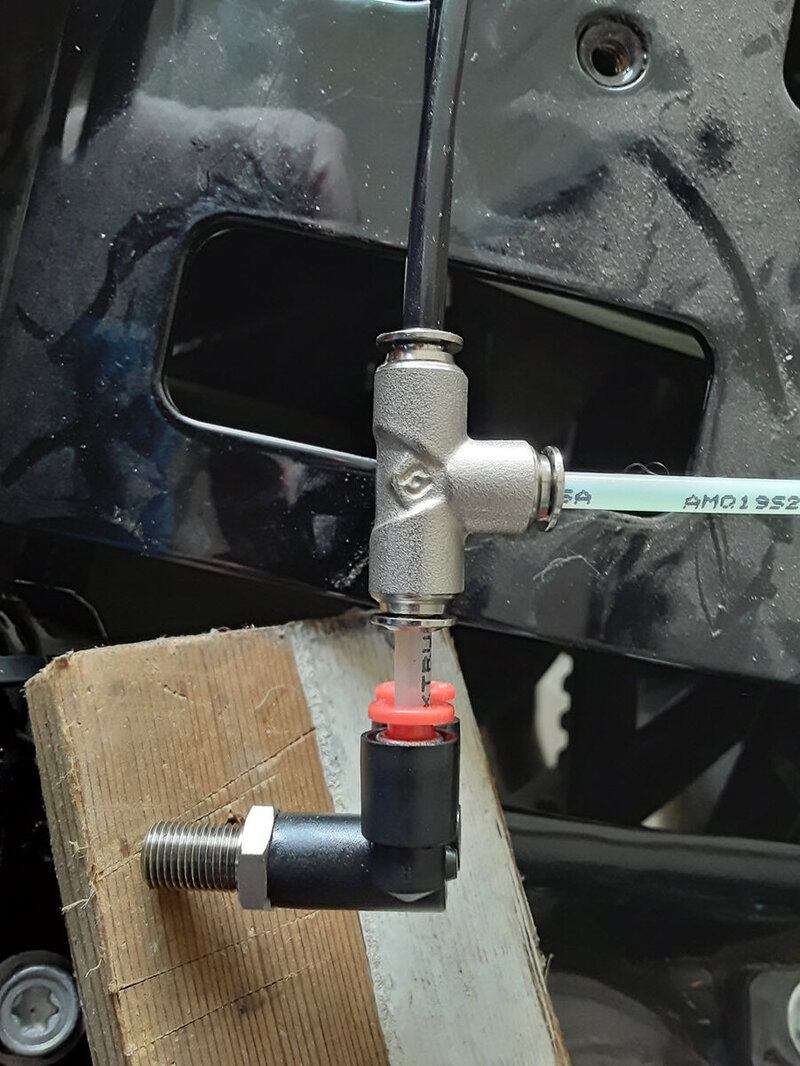

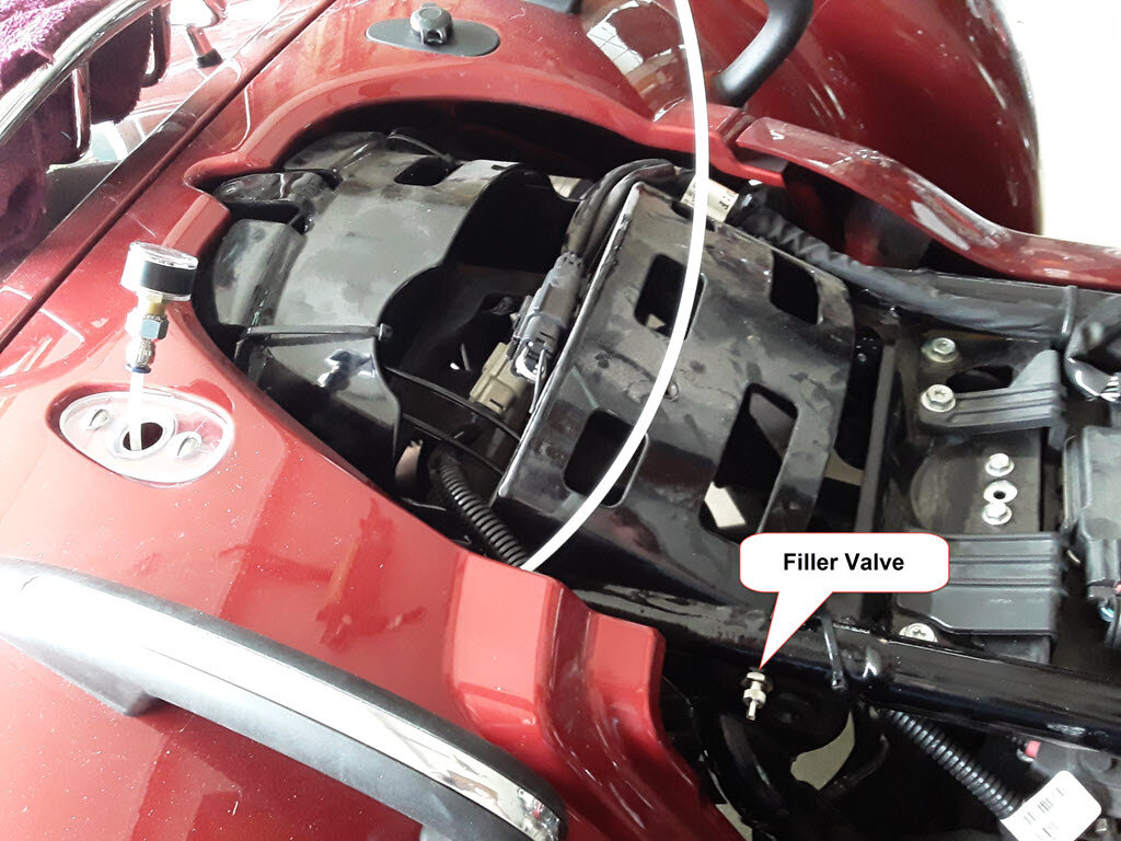

I plumbed it up by using a Tee attached to the fill valve.

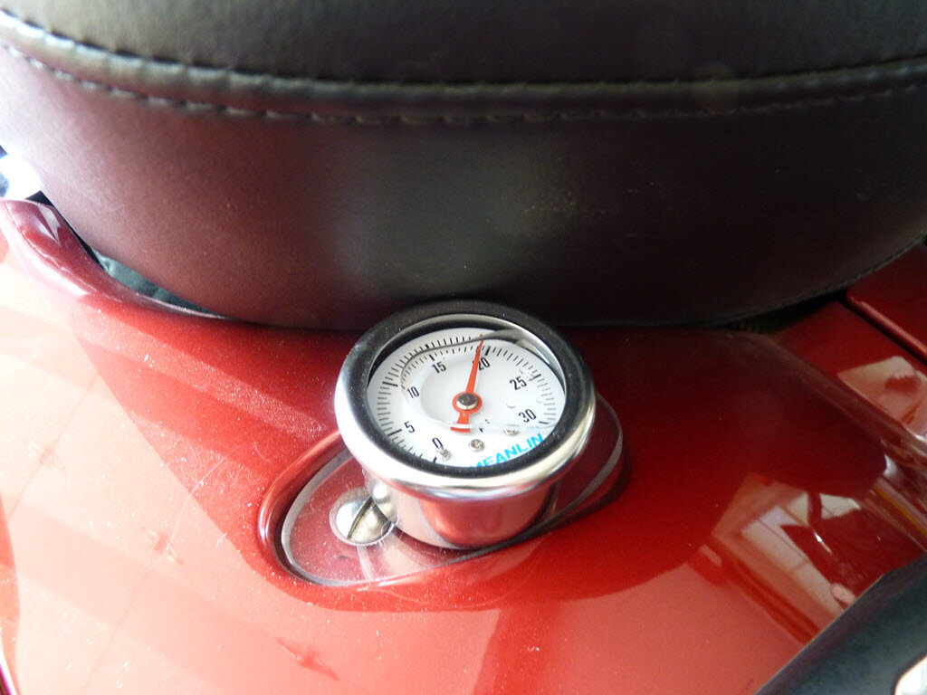

I went through two of the 1" gauges in a very short period of time. I replaced the 1" gauge with a 1.5" gauge from another manufacturer and it has been working fine.
