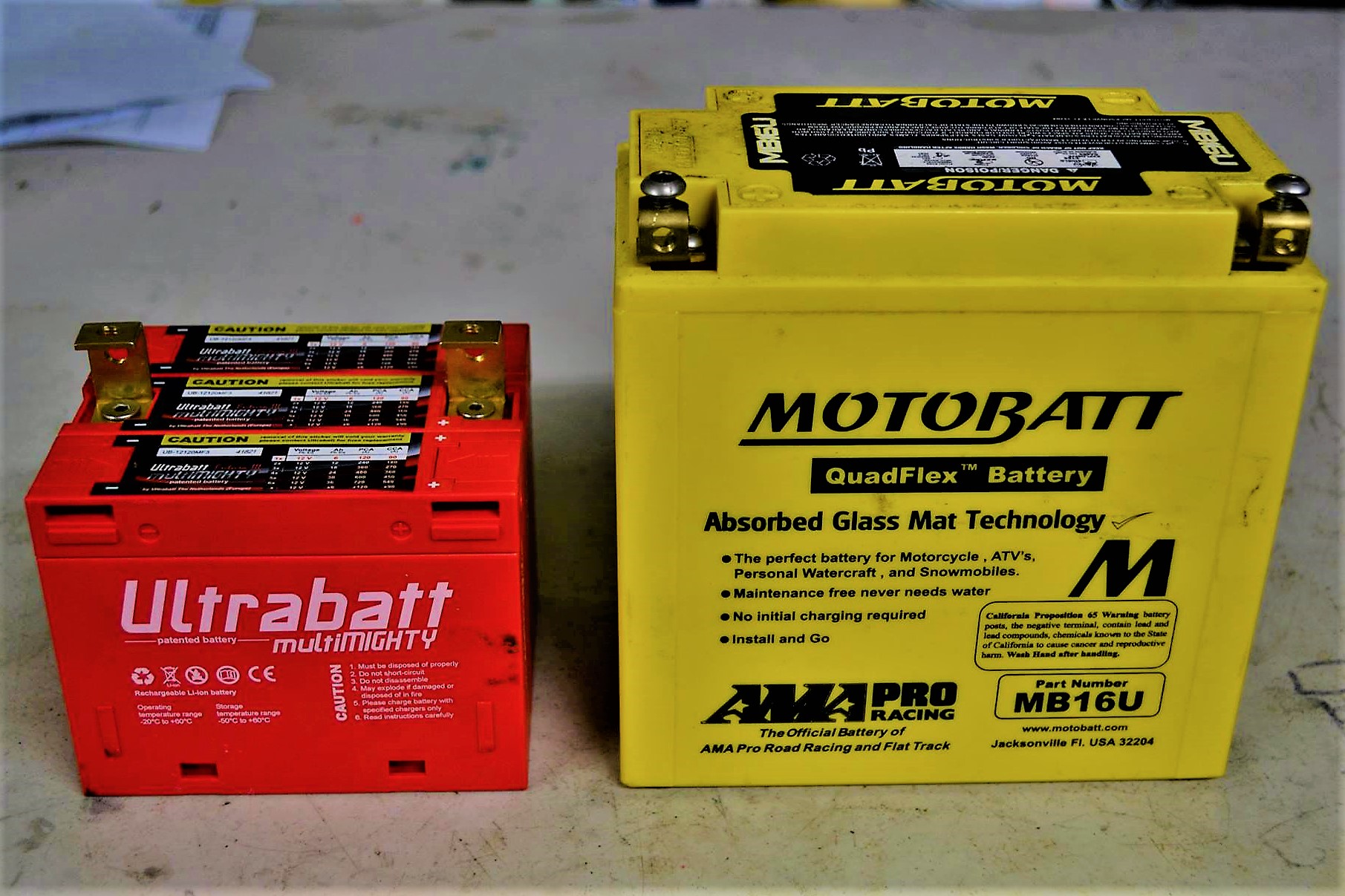

Lightweight and High Cranking Power?
The 16 a/h yellow Motobatt battery above is from a Ducati 900SS and weighs over 5kgs and is rated at 200 Cold Cranking Amps. The Ultrabatt Lithium Battery replacement for the same bike is rated at 270 Cold Cranking Amps and 360 PCA! Incredibly weighs just 1.4 kgs.
*For race use we would recommend a smaller battery for this bike weighing just 860 grams

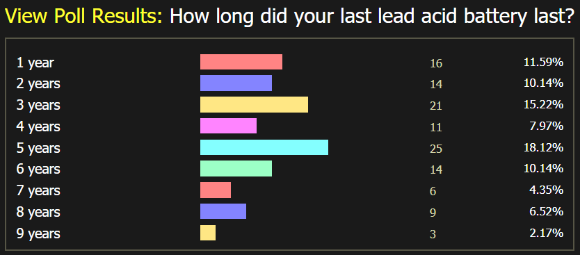

Do they really have superior reliability anda very long service life compared to lead acid batteries?
Customers should expect a lithium battery with an inbuilt BMS to last 5 to 10 years. By comparison a recent user polls showed that over 21% of lead acid batteries fail in the first two years and 37% had failed within just 3 years! By comparison warranty records show the failure rate for Ultrabatt's LiFePO4 motorcycle batteries was less than 2% in the first two years. (Ultrabatt's confidence is demonstrated by one of the industries only, full value 2 year replacement warranties).
