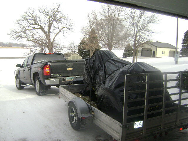

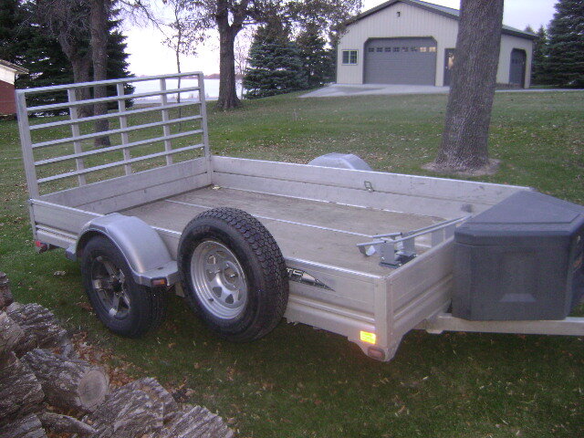

I went through the how should I transport my trike scenario about 18 months ago as we were planning a winter getaway to AZ. A decent car dolly will cost a minimum of $1100 and I was looking at extending the tongue and making a rail for the front wheel to sit up over the tongue but then I found a three year old aluminum 6 x 10 low riding trailer for only $500 more so went with that instead. I wrapped the painted surfaces on the trike with shrink wrap plastic and then wrapped it with a large heavy duty tarp since I knew we would likely be driving on salty, sloppy roads and I didn't want to expose the trike to that. I decided against an enclosed trailer for my situation as an open trailer is much more versatile for my needs besides everyone around where I live is always wanting to borrow enclosed trailers and I'm not in the lending mood.
pics of mine below, one with the trike ready for North Dakota to Arizona trip last February.

How is the lift gate secured...by just a pin? I'd think I'd also put a ratchet strap on each side during transport in case it somehow found a way to drop down to the pavement while moving, especially if you were to hit a good size pot hole. I do have a nice single axle trailer that formerly was used to transport my Father's aluminum boat and motor...would require some additional frame pieces welded on and two of my best friends both own welding businesses. That's an idea to consider.

I use Snap-Pins on my trailers gate, Same kind that I use on my
loader' to hold a 8Ft brush hog, and a York rake, They never work loose.. Besides locks tend to gum up from the spray off the rear tires. ie Sand, Salt, Mud..
