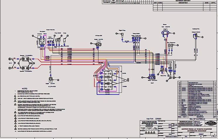

Nick at TBMS sent me the schematic to check things out instead of driving the 130 miles to Troup, TX. if I could find the problem it would save both of us time.
Silverdevil, I would very much appreciate that schematic if you could send it to me at cutlerdk@frontiernet.net. By the way that was very informative in describing how to access it...not easy...but at least doable.

right now I am on a trip and when I get back to my desktop PC I can send the schematic for the AC. I will be back near the end of the month.
below is the schematic for the A/C on the stallion
Thanks, I saw I got my "personalized" copy from you this morning.
