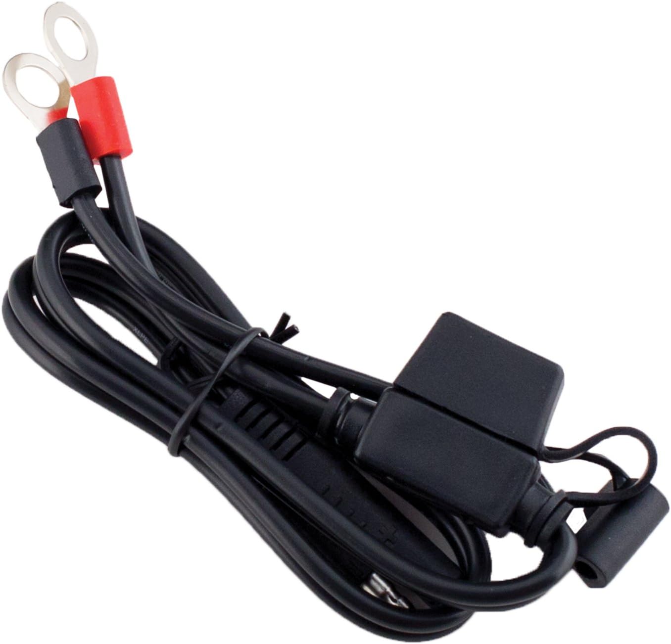

Here is a battery tender 2 ring cable with fuse holder. The fuse is 7,5 amp
follow your tender wires from the battery
in line fuse holder
dike the fuse holder off and re locate it near the plug in. soder it. then its easy to check
