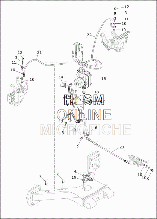

Tried to search, but won’t accept ABS due to being to short. I believe the ABS is not working on my 15 TGU. Was working last time I tested it…front wheel now locks with only moderate braking. Thought fuse might be bad if there is one.
TIA
Is your ABS light on the dash lit all the time?
Have you run a diagnostic check on your trike?
I do not think there is a seperate ABS fuse. The pump is wired into the wiring harness under the side cover.
You could remove the plug on the pump and carefully do a test ride. This should allow for normal use of the brakes. ( If you try this be extra careful during a test ride)
Harley had a lot of problems with the early ABS pumps. A scan of your ECM may give you a DTC that would steer you in the right direction
Good luck and let us know how your Trike is

My 17 was doing this and it was a bad caliper, warranty replaced it and its been fine ever since.
If you do not have #15 behind your right side cover you do NOT have ABS
I recently traded in my '15, there is no ABS, they're linked like others have mentioned.
