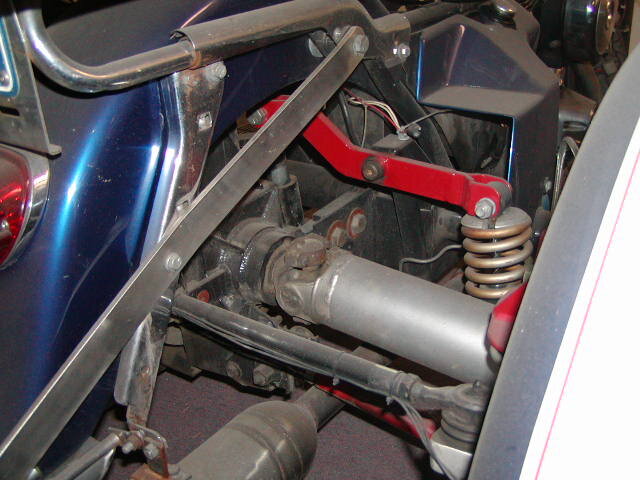

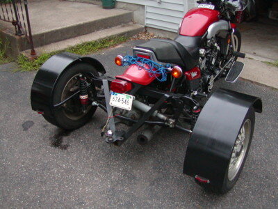

you can make a compesator for that.. here are 2 examples one has the linear actuator hooked to one spring so it holds the weight of the trike all the time other is hooked to both shocks so u dont have that issue..... if i am on a fairly straight road i can steer with the lean switch
Do you have any more pictures of that setup.
