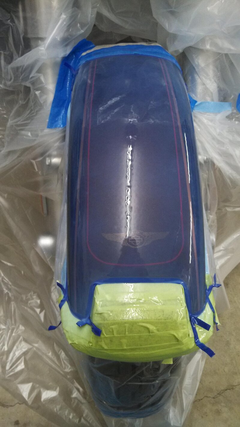

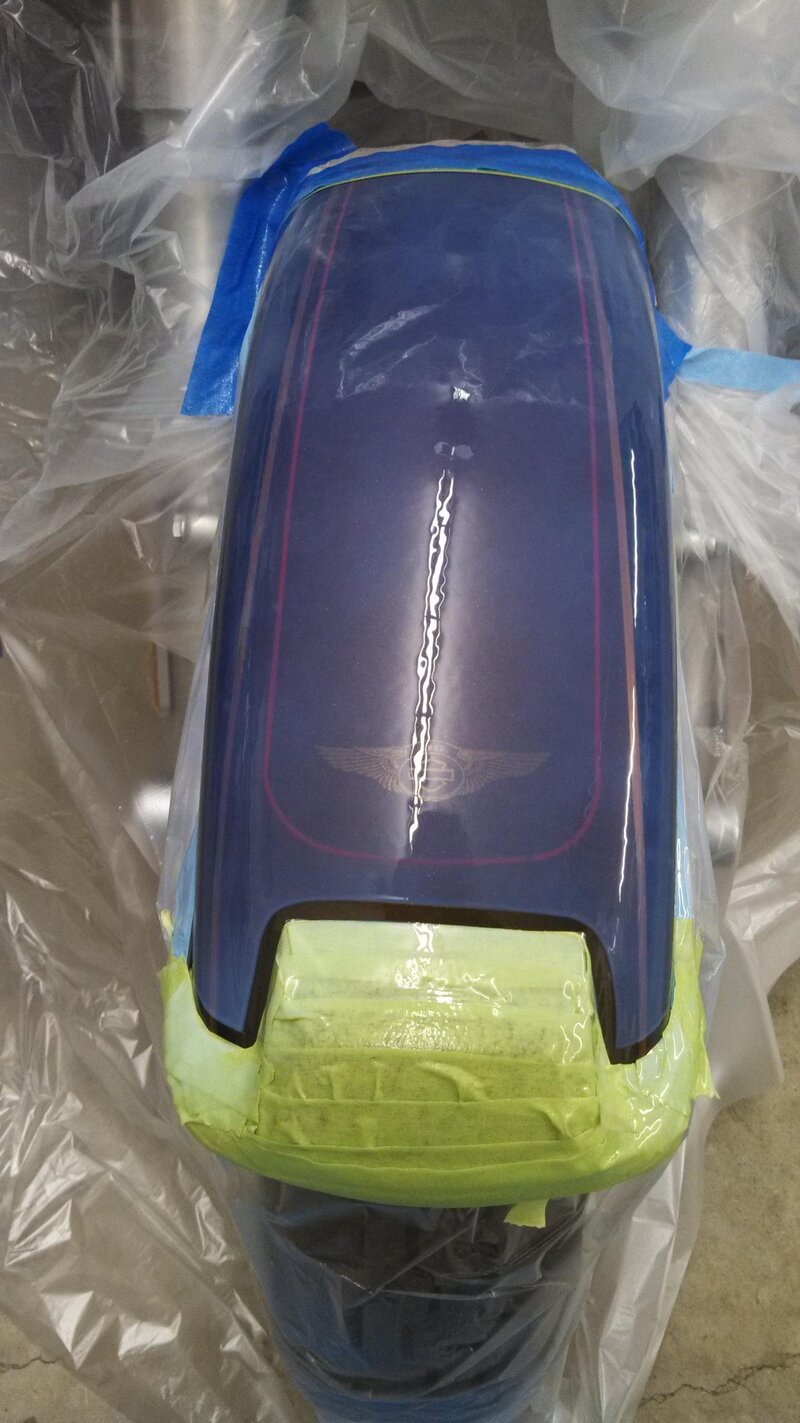

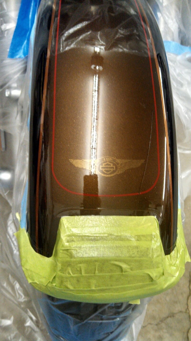

It took much longer preparing the surface than it did to spray. The taping process especially on the lowers took quite some time as I completely dismantled them prior to spraying. I taped off the areas that were covered by the upper part of the lowers and taped off the vent areas. So far I am very pleased with the results. Peace of mind!
Here are some pics to go by. The last pic you can see the film edge. It is not completely dry when photo was taken. The line is not nearly as noticeable now that is cured. Like I said, very happy with the end result.
