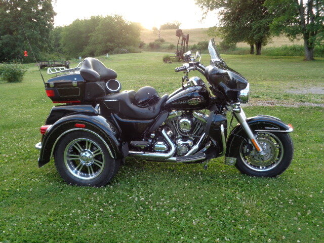

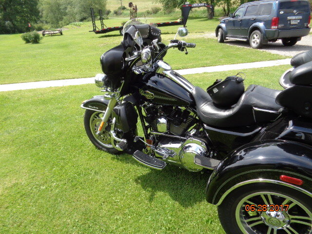

DSC00552.JPGDSC00555.JPGDSC00272.JPGDSC00270.JPGTony I our trike is a 09' and the OEM 32 tooth 6th gear was useless. Swapped out to a 30 tooth Our trike is like a completely different machine, all round better. You should consider cost of change and overall effect you are looking for I have no knowledge of what it will cost for cams and or Pulley change, my change was done when my Stator and regulator went south leaking oil from old age. If you do the TTS 100 cams I don't believe you would need to mess with the gearing I believe Gorrilla a moderator here went back to a 32 tooth pulley after cam change. Depending on how long and how steep the terrain you may look at a 31 tooth pulley and go from there. You should shop around and get what you want don't settle you will not be happy in the long haul please don't become a settler. These thing are a very large investment so do it right the first time. We ride two up all the time and I believe we do well here in Pennsylvania with the mountains we have. You can see my signature line and see what I have done to get where we are at.​
