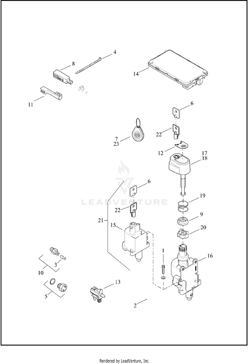

I removed and reinstalled the ECM connector to get at the battery terminal. I'll see if I can find the BCM.
#14 is your BCM, it may be under your LS cover
