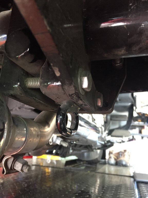

It is raining here so I decided to make some lifting blocks to help when jacking up the axle as it is always a pain to get a jack in there to lift. I find using a scissors jack on the frame like is shown in the manual to lift the rear basically lifts the entire trike even when the front wheel is brake locked and tied down.

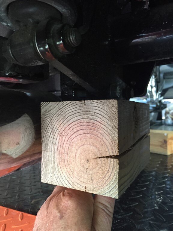

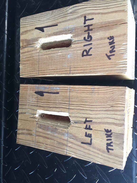

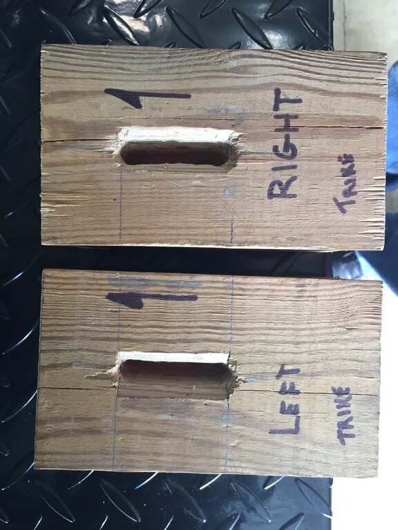

I made some blocks as shown below to fit over the tie down loops on the rear axle pinch block. The part of the pinch block with the loop looks to be welded to the axle and should provide a good support point for jacking. I have 2 floor jacks and will probably use both to lift the rear and then set the axle on jack stands. Used a couple of 6-inch 4x4 pieces and drilled out a slot 2 inches long 3/8 inches wide and 1 ¾ inches deep. Used a wood chisel to clean it out. They seem to work just fine.

Tie down loops on axle pinch block:
Home made blocks:
Looks good to me, I made one out of a 2 x 4 but have never used it yet so I really don't know if it will work, had the 2 x 4 laying around, cut off a chunk and drilled the holes for it to fit the loop, have heard of the loop bending when using a floor jack so I thought of this, you went with a 4 x 4 which would work better and stronger, I haven't used mine yet so don't know if it will work, one of these days, LOL:D

I like what you did. Did you center the opening or did you or off to side? Thanks
Side to Side they are centered. Front to rear they are a little forward to account for the length of the pinch block so they support it the entire length, hence the arrows and right left marking. I held the bock's up to the loop and tapped the bottom of them with a hammer to get a make on where the cutout would be.
