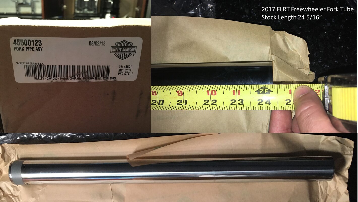

Can't answer your question,but you hit the nail on the head with HD standard answer of whether something will work or not.
Just looked at the PM legs. It could be the internals. Call Tim at Custom Cycle Engineering. 760-941-6487
He is the expert on tubes and legs. He helped me "discover" what the Freewheeler had going on. Likely (if it is internals) he can help you bridge the gap with a new set of tubes that will fit the FLRT Trees at the right length for use with different internals and the PM lowers.
Welcome to the world of FLRT Customizing. :Dorag:

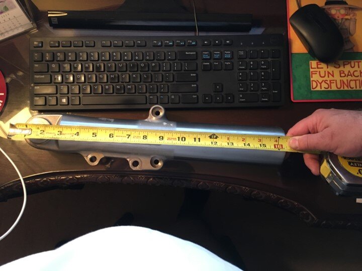

Hey Free Bird is it the angle of the pic or did you "burn an inch" on that measurement. I measured my oem RGU lowers and they are 15" long.

The picture sucks, but I stood them upright on the table to measure from the lowest point to the rim. 16.5" What year is your bike Mine is 2017

I just checked again. 16.5" If you want something more accurate I can take it to the shop. It's about 1/32 shy of 16.5 just by eyeball. Were you able to call Tim.. I'll bet he can solve the PM mystery. My guess is still the bolt hole at the bottom and compatibility with the internals (FLRT vs FLHR family)

Thank you Free Bird, tape line and eyeball is good enough. mine is also about a 32nd shy of 15 also. I haven't reached out to Tim yet. scared of the cost of custom fork tubes hahaha. may just settle with machining the OEM lowers to clear the wider tire and get them chromed. I have an email in to Native to see if they keep OEM chrome/machined trike sliders on the shelf "since it wont work hahahaha" or if I need to send them mine to get machined and chromed. Since the PM Route might get really costly. haven't decided yet.

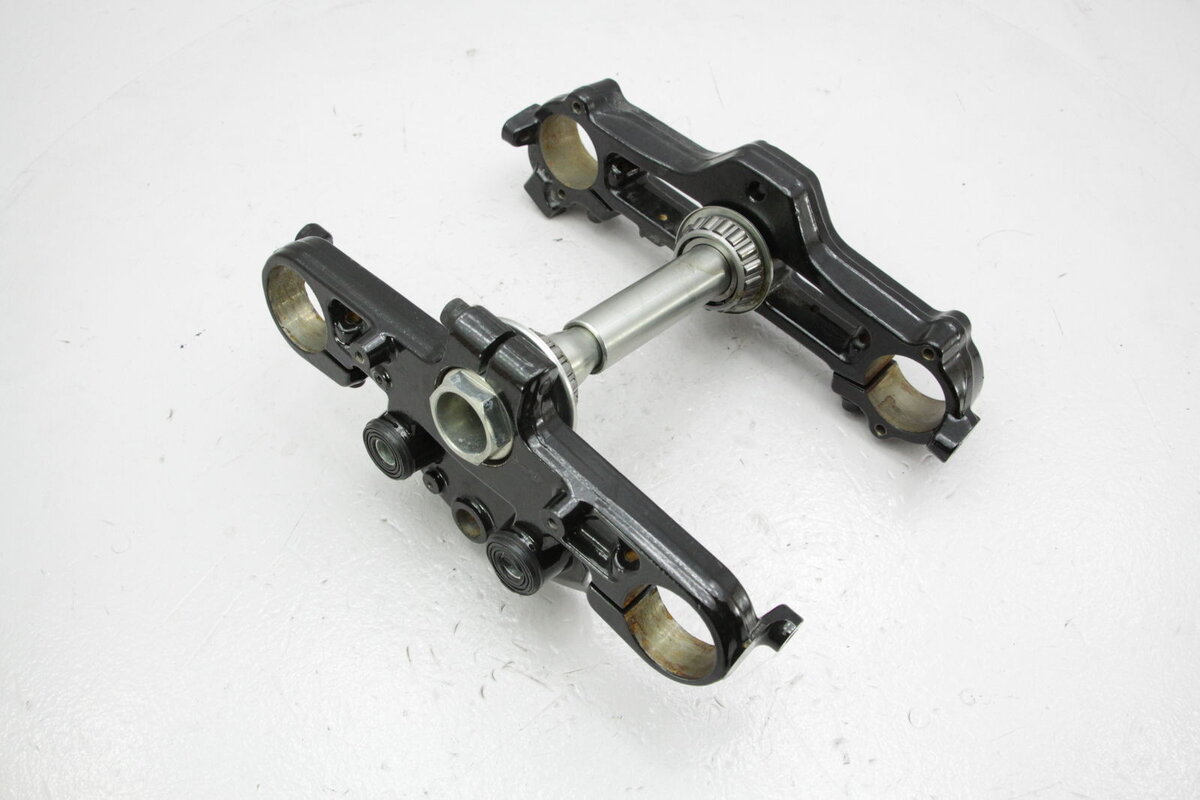

Freewheeler triple trees are narrower than the rest of the touring family trees. They are not FLHR trees. Here are 2017 Freewheeler Trees

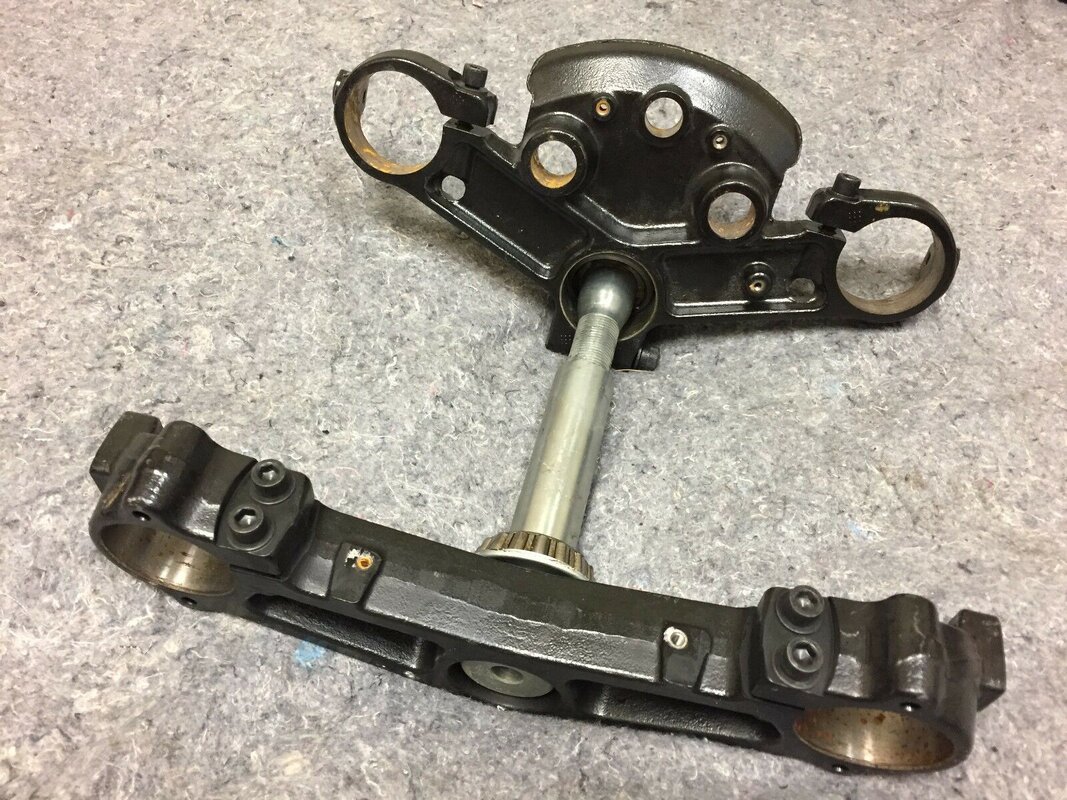

Here are 2017 Road King Tees
So make sure to define the spacing needed between the tubes when defining how much to mill off the sliders.
