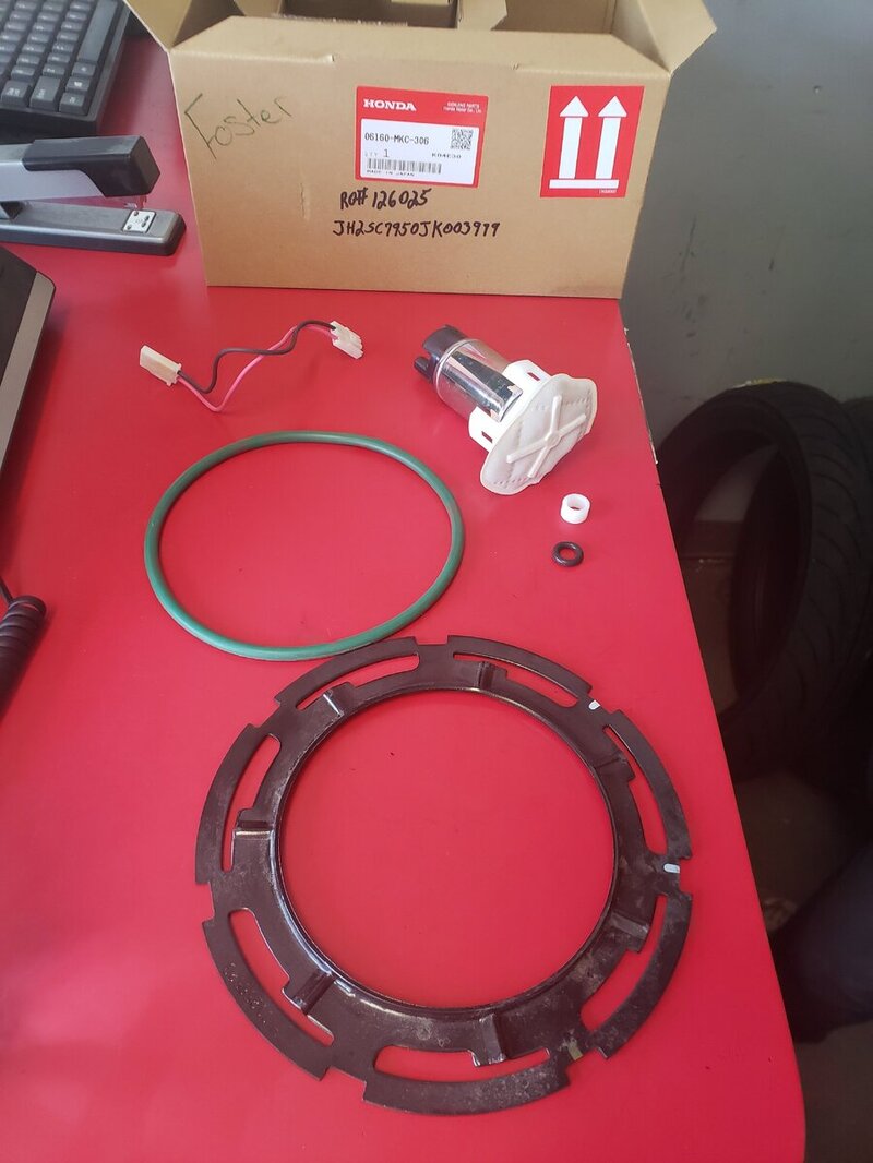

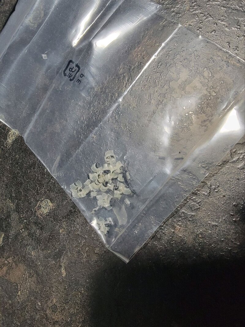

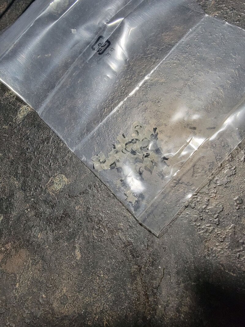

I took our 2018 Honda Goldwing DCT Tour with CSC Encore Trike Kit to Scottsdale on Tuesday and had them install the new fuel pump. Mechanic said they have done 12 so far and he has done 6 himself. Took about an hour and everything went smooth. He gave me a plastic bag with some plastic crud/items in it that was in the fuel pump. I will post a couple pics below if possible. He said in the other 11 fuel pumps, he didn't find anything in them, so mine was the first. Took it for a hundred mile ride up to Heber yesterday, and noticed quite a bit more power and now wondering IF those plastic items were plugging the pump somewhat? I asked him if he thought they were from the extra tank from the Encore Trike kit or from the pump. He said they were from the pump, would be his guess. Western Honda Powersports in Scottsdale did the work. They have 2 White and Black Goldwing Tours with DCT and one dark colored one in a manual if anyone is looking for one.
Plastic items in fuel tank of 18 Goldwing.jpgPlastic items in gas tank of 18 Goldwing.jpg
Thanks for sharing this John, and WOW!
I'm pretty certain that non of that material came from CSCs auxillary fuel tank, certainly not the larger clear plastic pieces. If it all came from Honda's fuel pump it is a LOT of material. I'm wondering what kind of pump failure would produce so much debris? Whatever it was would certainly justify a recall.
Yep, I just read that the early pump assemblies had materials (the jointed plastic hose) that aparrently were not gas impervious, broke down and were sucked into the pump and chewed up, destroying the pump.
I should add, after they changed my fuel pump and found all that plastic garbage inside the old pump, I couldn't believe the difference in power, before and after. A world of difference, especially when hitting the throttle to pass a vehicle or going up a big hill. So those plastic pieces were stopping my gas flow somewhat.
