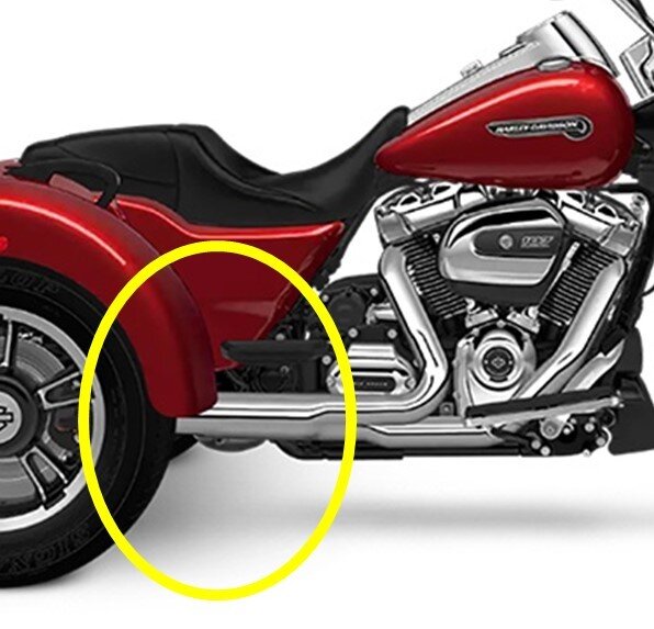

The challenge is the exhaust exit at the rear tire location.

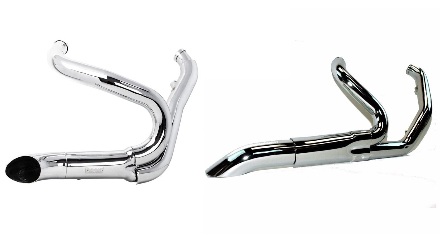

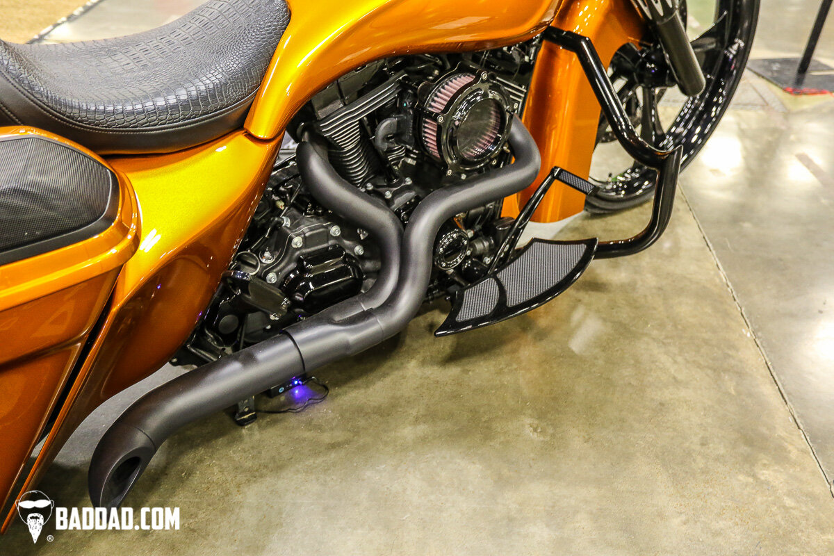

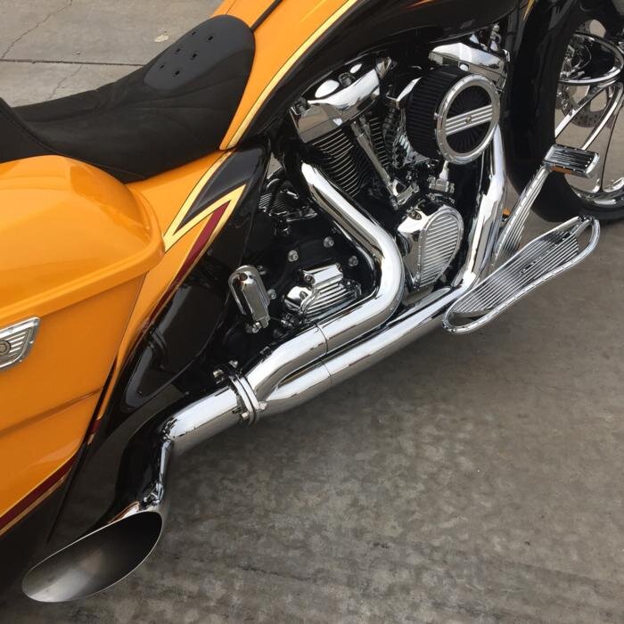

Many guys make two into ones for the M8. Here are a couple and you can see the challenge
Most of them could have a modified aft section fabricated that would get the exhaust gas dumping outboard of the tires... You just have to get creative and get a good fabricator to help if you can 't do it yourself...

In that case I would start combing the internet and find the head pipes that travel the least distance aft and then talk fitment with the maker. Look at the Bad Dad ones above compared to the Covington Cycles one at the top. The Bad Dad collector starts right at the aft tranny cover bolts whereas the Covington one bolts on 3-4" past the aft tranny bolts. I know this is stating the obvious, but I don't know the specific brand differences. The other approach is have a set mad as a one off... more expensive, but then you know it fits

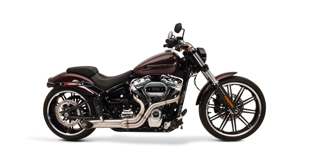

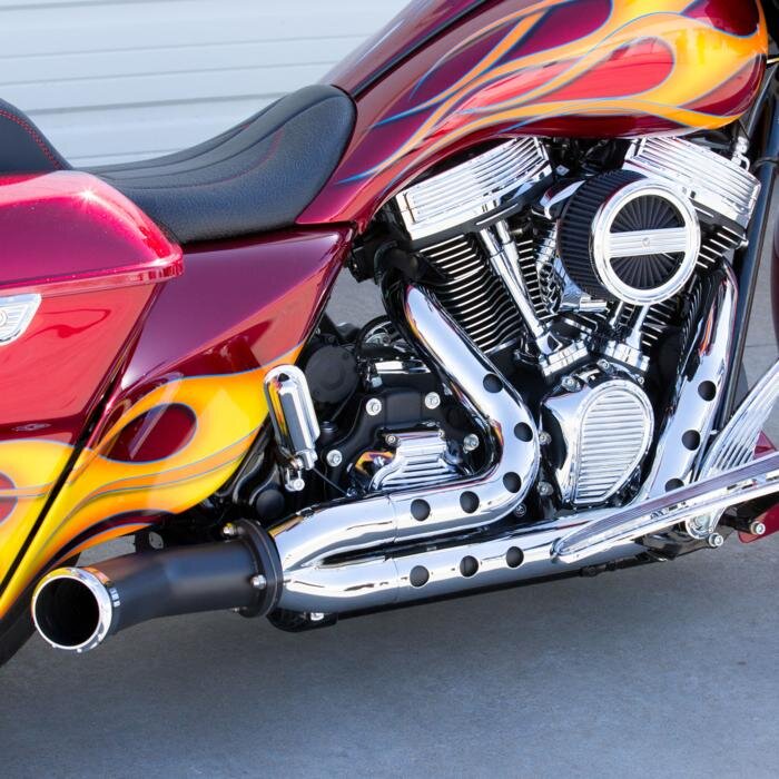

Here is an interesting possibility from SuperTrapp. Looks like the old 78 Low Rider collector pipe system. (Naturally I love that) But.... It could be cut at the collector and give LOTS of room for a turnout that would clear the tires in the Freewheeler. Just another thought...
Of course the pic below may be better used as a blueprint... the mind boggling cost of 6 feet of pipe from a brand made exhaust might lead you back to a custom fabricated set of pipes as they may end up being cheaper... (support your local garage builder fab shop)
