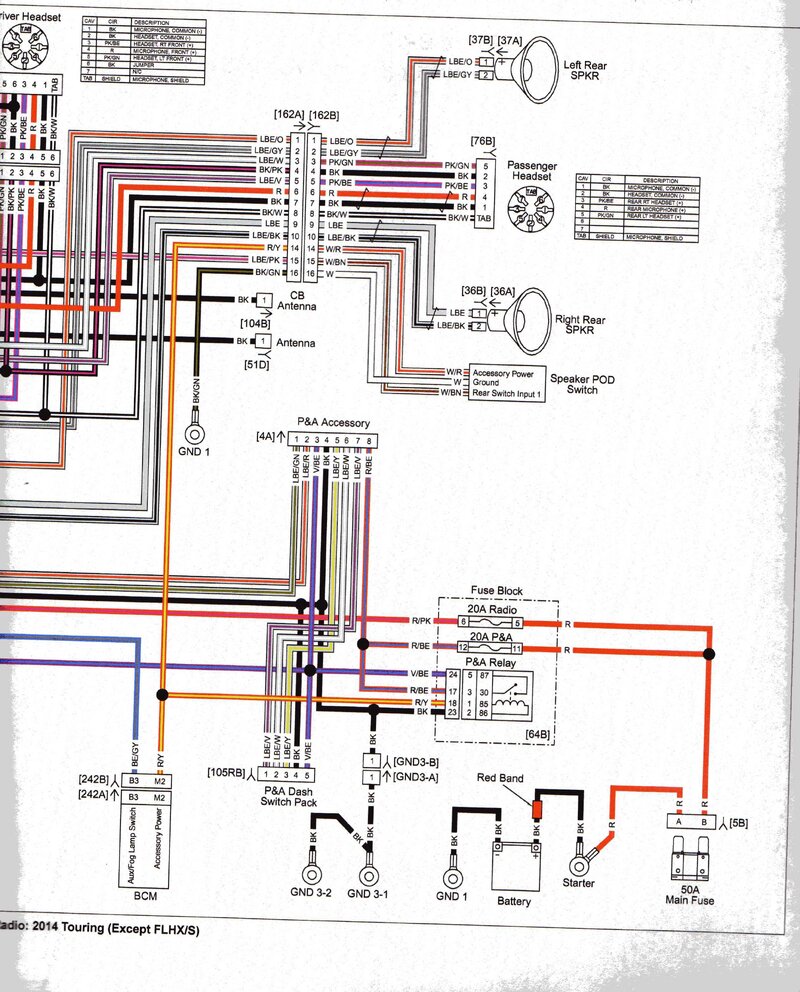

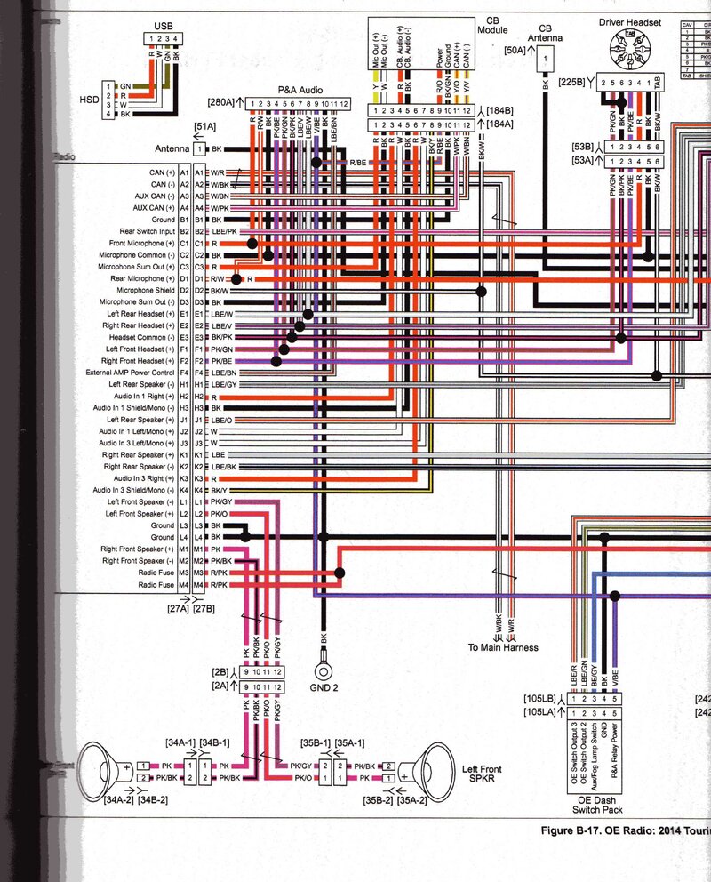

Anyone have the diagram? Haven't had a chance to pick up the service manual. Trying to wire front speakers to an amp and the colors make no sense, don't wanna reverse polarity.
