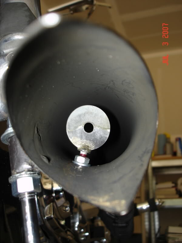

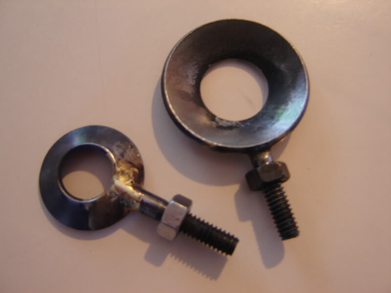

The cones you have look like a spin on the age old lollipop trick tuners would use to gain back some low to mid range torque from an exhaust in which the baffles were removed. Simple washer of the desired size welded onto a stud then drill a hole in the muffler body and bolt it up. They play with washer size to get the desired torque curve.
The Inserts you have look like a spin on the age old lollipop trick tuners would use to gain back some low to mid range torque from an exhaust in which the baffles were removed.

The Thunder Torque Inserts absolutely have their genesis in lollipops. But they are quite a bit more. Especially the W Series.
I have been playing with lollipops for over 35 years in a variety of exhaust systems.
Back awhile ago, due to frustration with the expense and poor performance of the majority of aftermarket exhaust options, we spent 3 years testing hundreds of variations to come up with the best combination of materials and shape to achieve the best increase in torque across the RPM band...that is low cost AND works in virtually any slip-on, drag pipe and full exhaust systems (true-duals or 2-1-2).
