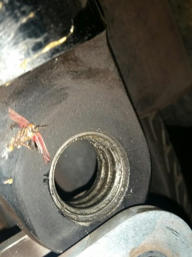

Ted, at the end of the swingarm (bottom of the fork tube) there is also a 2" double row bearing and it is a bear to get out unless you remove the fork tubes and press them out. Tom
Thanks Tom. I will be looking at those. How did you get them out? Remove the tubes?
I recently rebuilt my forks and I used an oversize socket and heavy washer to press out the old fork bearing. Both sides came out without a problem. A few years ago I had one of these bearings fail and all that was left was the outer race. I ground it thin with a diamond burr and knocked it out.
No, I beat them out in place ! Only took 2 days! Should have removed the tubes and did the triple tree bearings but didn't. The 2" bearings come out from the outside which doesn't allow you much room to use a punch between the tubes, then you have to drive the new one in from the outside. Much easier to use a press even if you need to take it to someone.
3517-MMS-1483044526494-attachment1-20161229_154110.jpg2016112995145618.jpg2016112995144303.jpg part number, bearings removed and outer park of bearing that had to be beat out! Only have a small slot from the inside to be able to drive it out. You have almost the complete outside race of the bearing to press out if you remove the tubes. Hope this helps. I'll dig up the part numbers for the 4 caliper bearings if you don't find them already posted. Tom
When mine failed in 2012, it made for a lot of slop in the swing arm which made braking real scary. It would dart to the left with the slightest brake application. When I disassembled it, there was no sign of any of the balls.
