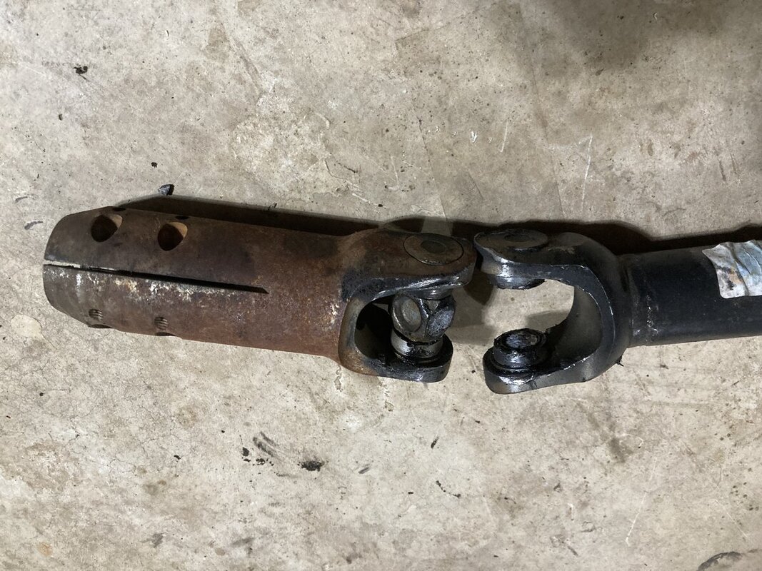

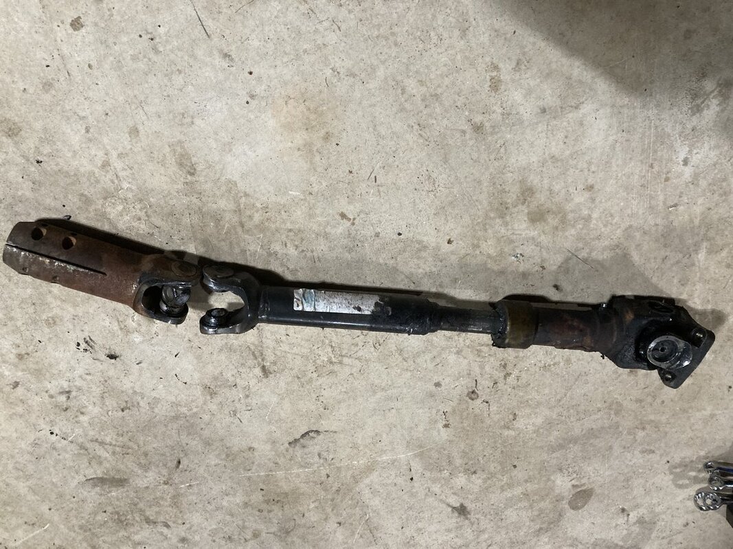

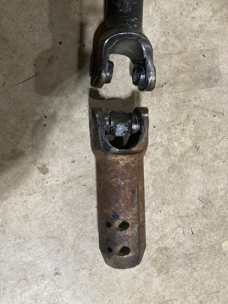

Front sealed ujoint snapped completely out ! Even if I could replace the ujoint there would no place or opening in the bikes frame to maintain the grease fitting. IMG_4303.jpegIMG_4302.jpegIMG_4301.jpeg
Looking at that u-joint, I don't see a zerk fitting to use grease in first place. It may be a permanently lubricated u-joint that doesn't need grease?
I dont see what would make that snap like that ? I think a good machine shop could put a U Joint in there .
My only concern is the front side of that driveshaft appears to be a bit damaged in front of the u-joint around the edge and also appears to be bent out a tad. If so, the full driveshaft probably does need to be replaced.
Yes it is made that way (sealed) so it never needed grease maintenance because there is no opening room on the side of the bike frame👍 No other choices but to spend $1200 bucks

Found the invoice. I used a SKF UJ838 and a Moog 240. Also some very good pics of the shaft and neapco part #s for the joints in this thread. Champion driveshaft
I ordered both u-Joints front and rear confirmed by champion trike. I just took another look at my rear u-Joint and noticed it had no grease fitting on it either. There is a grease fitting on the shaft itself though. The new rear u-joint I ordered has a grease fitting on it, I was going to replace it as well since I had it off.
