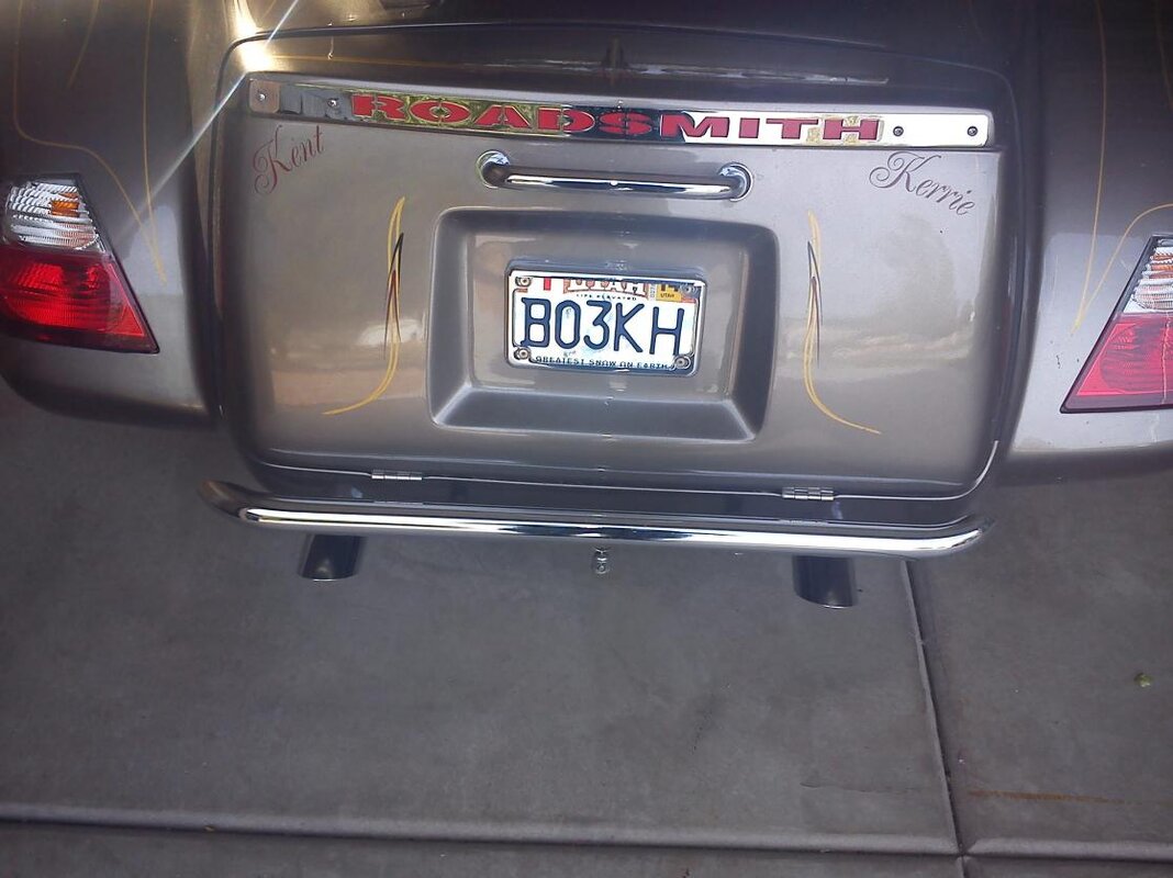

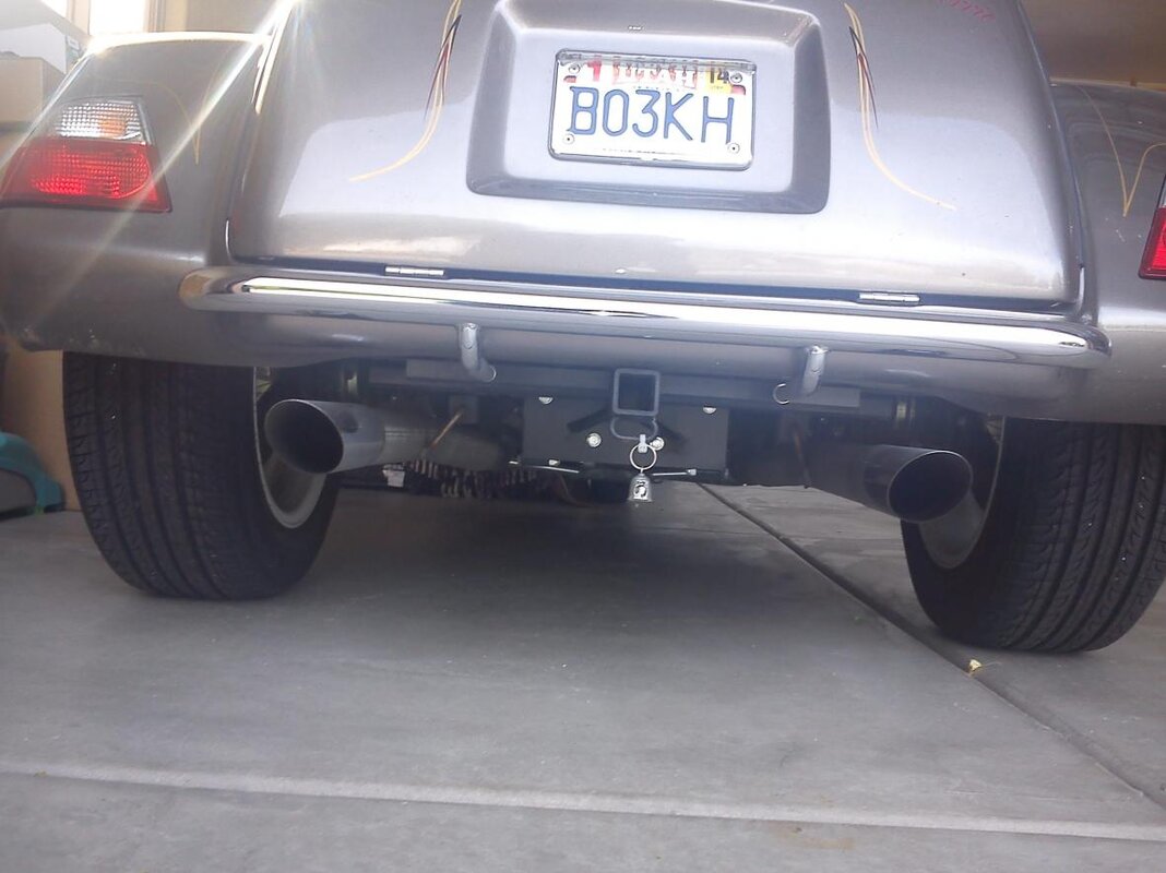

I just posted a thread regarding the "Trike 6" Extended Daytona Power Mufflers" by Torq Master. And I see that you also have a Roadsmith conversion as I do. In relation to the back of the trike/trunk or nerf-bumper, where do these pipes end?

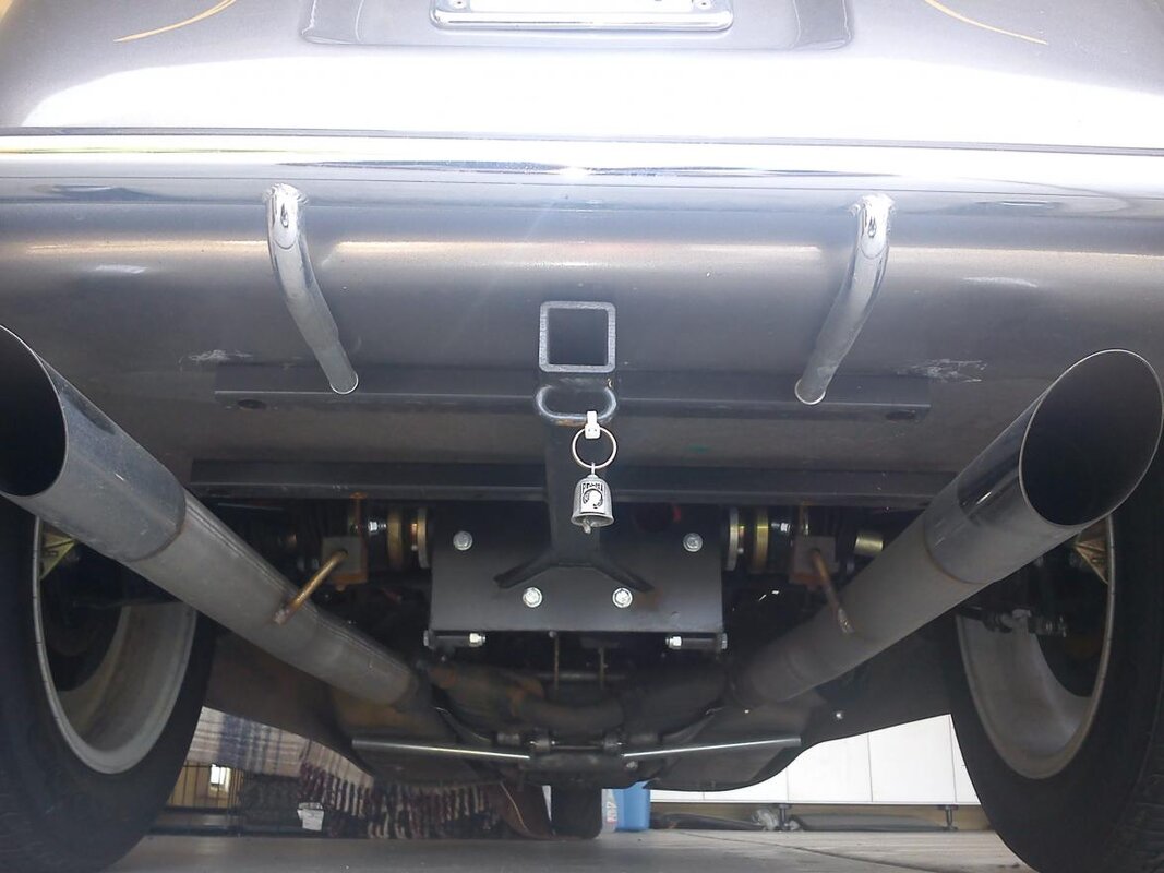

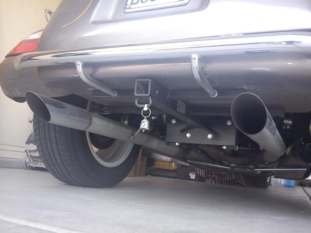

I recently tried several options including trying HD mufflers and finally ended up removing the Honda Mufflers on my trike, ran straight pipes where the stock mufflers before were mounted, added end caps and ended up with a great sound. My trike is a 07' Honda 1800 with a Lehman kit. I now have several others wanting to do the same.
Something like this????
