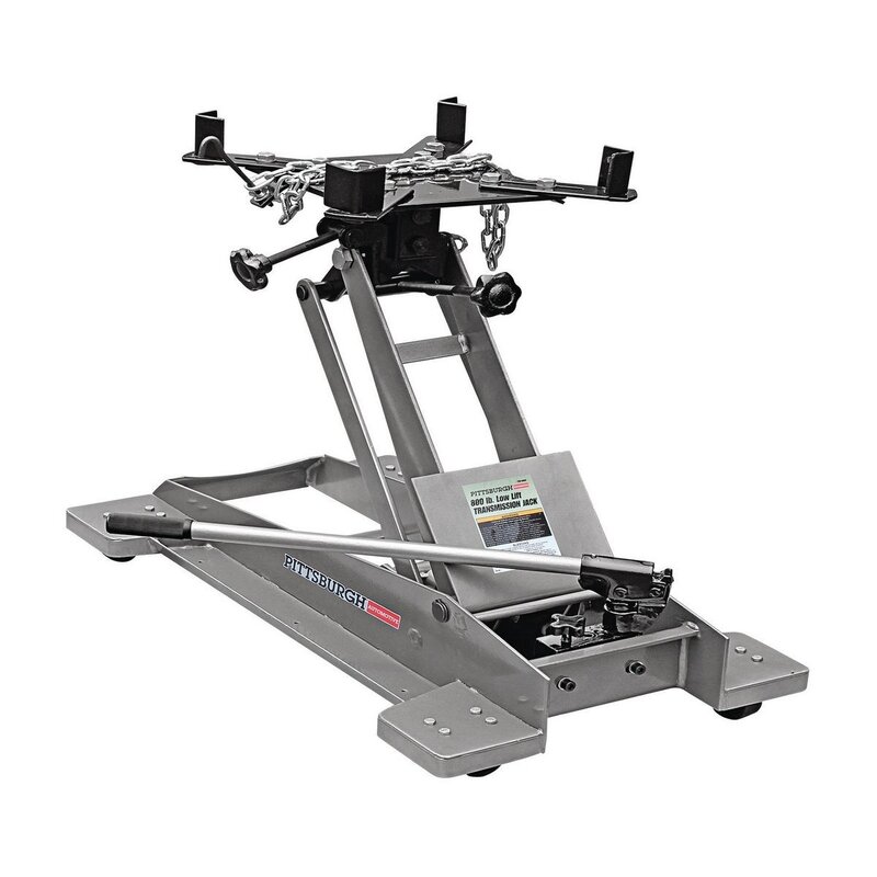

I use a transmission jack with a block of wood on it. The wide base makes it a LOT more stable than the floor jack. Didnt buy it for the trike, had it already.
I got it on sale for ~$135. https://www.harborfreight.com/800-lb-low-lift-transmission-jack-60234.html
Especially when I tried to raise the rear high enough to put in jackstands - my offset diffy makes it hard to find a good balance point with a floor jack. I lift on the tube framing of the kit now, with a wood spacer. Not sure if your kit permits that. If not...

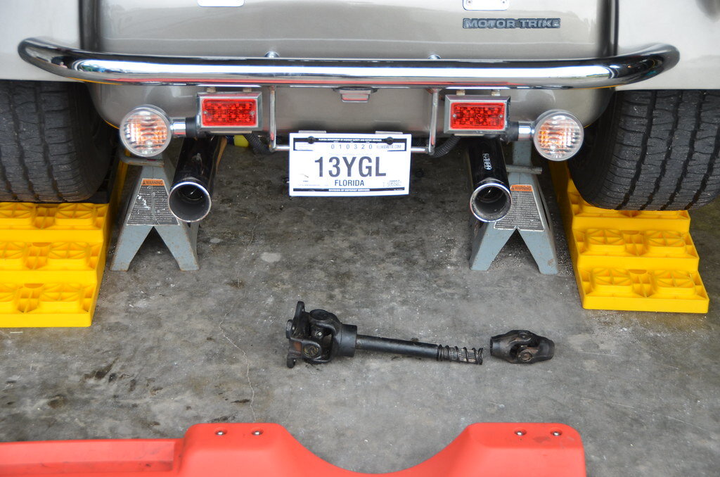

If you are just trying to get it in the air a bit, RV leveling blocks worked great for me. If you want to remove the rear tires, I would put the bike up on the blocks, then use a floor jack to lift it slightly one side at a time and put in jackstands. Took more time, but a good alternative if you only have a floorjack. Trying to lift it high enough balanced on the jack without the blocks was scary. The 'RV blocks' could just be wood scraps, we have a camper so I had them around.
I was removing the driveshaft, so I needed the tires off the ramps. You can see the right ramp is loose, pushed forward.
For raising the front, I use a similar method to Crystal Pistol. This gets all 3 in the air. :clapping:
