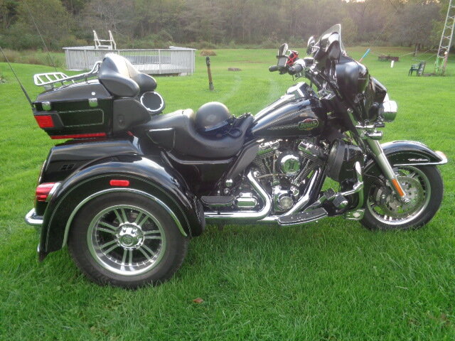

This is what the OEM look like this picture is 2014 spring, getting out of garage asap.

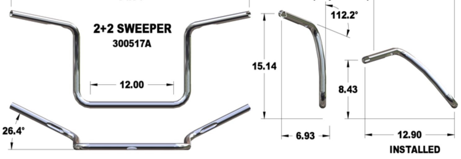

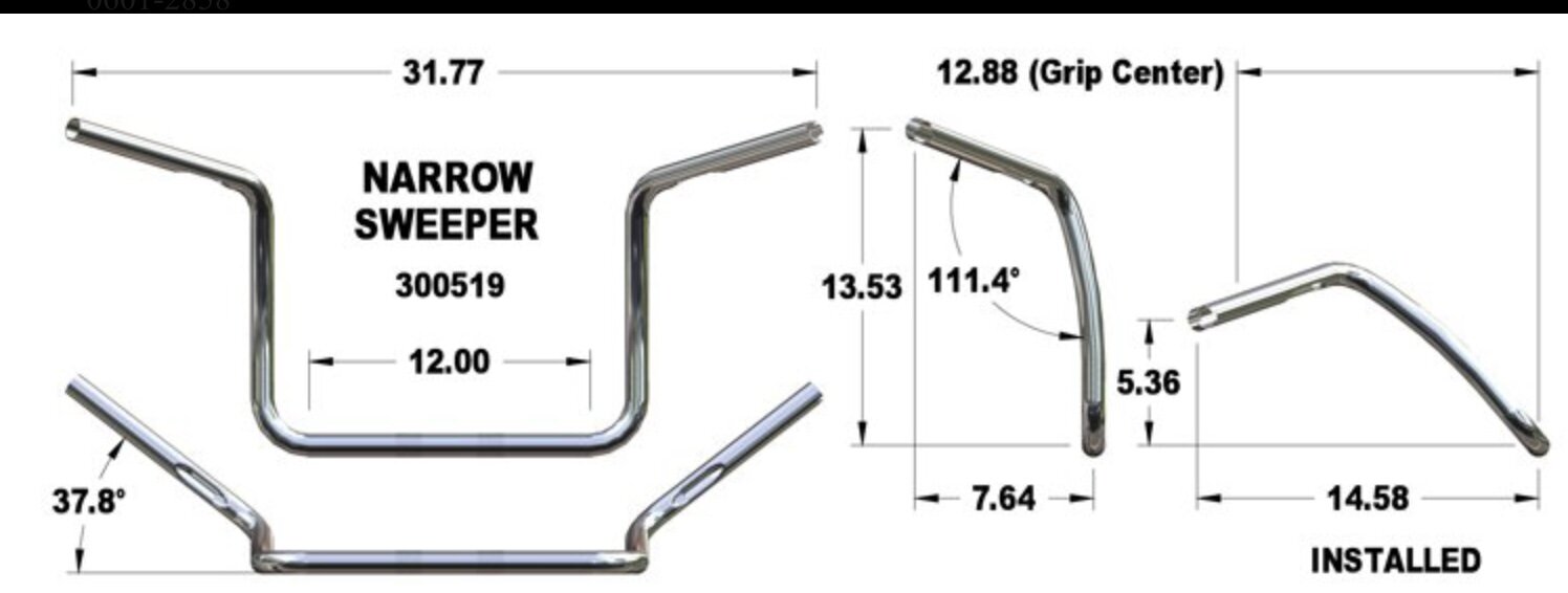

I had the KW wide sweepers on my Ultra Limited for many years and loved the perfect ergonomics of them. For me it was all about wrist angle and the pain induced from the stock bars. I found the narrow sweepers are almost the same as HD stock, although they do have the mentioned benefits of being closer and higher.
I fully plan to put the KW wide sweepers on my TG and can’t wait!

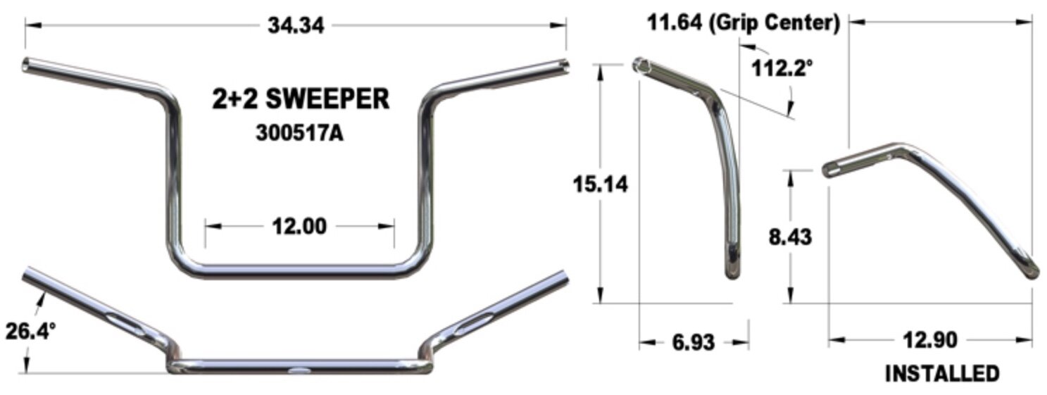

for reference between the two bars, look at the detailed specs below. They may help anyone hone in on the importance of what you’re looking for. Note the wrist angle between the wide and narrow models as well as height and distance back to grip center. It’s a lot more than just being wider.
hope this is helpful
