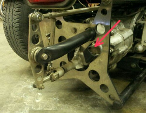

Replaced generator with alternator. Now looking to figure out where to connect Reverse light, so I know when shifting wrong. It's somewhere on that manual tranny. Just haven't spotted it yet. 1970 VW Bug engine and 4-speed tranny.
Mine's on the front of the tranny, next to the rod you hook the the linkage to.
Like Doug D. said
On the nose next to the shift rod.
Not all have it though. I think 66 or 67 was the first year for the switch. So some early swing axles will not have it at all.

Also, just took a close look at tranny in daylight. Seems this one just doesn't have reverse light switch.
