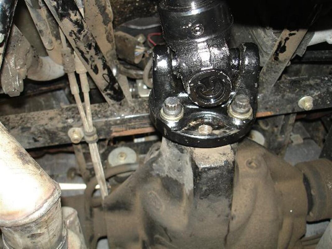

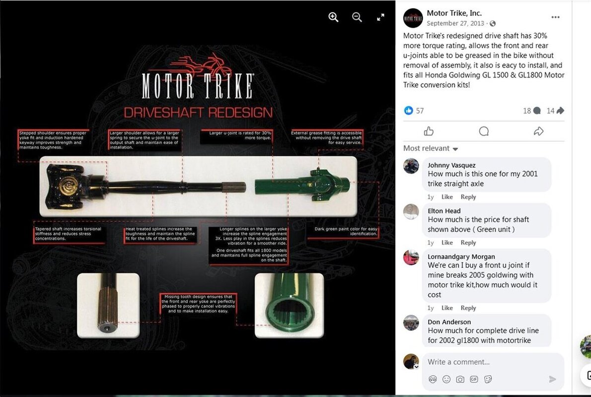

Motor trike has a new, redesigned driveshaft with front and rear u-joints that can be greased. A big improvement. I just asked them about it. The shaft is green. You have to order it through a MT dealer, something like $350.Motor Trike Gen III driveshaft (1) (Large).jpgMotor Trike Gen III driveshaft (2) (Large).jpgMotor Trike Gen III driveshaft (3) (Large).jpg
