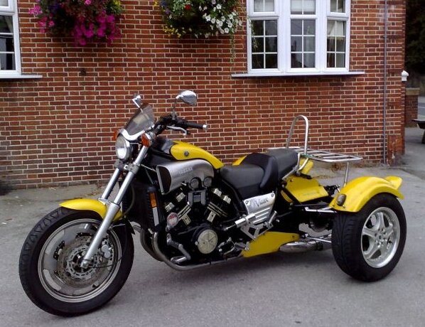

Congrats Craigr! Jay, Yes, a V-Max trike pulling a trailer would fit the bill. <img src="images/smilies/smile.gif" border="0" alt="" title="Smile" class="inlineimg" />
