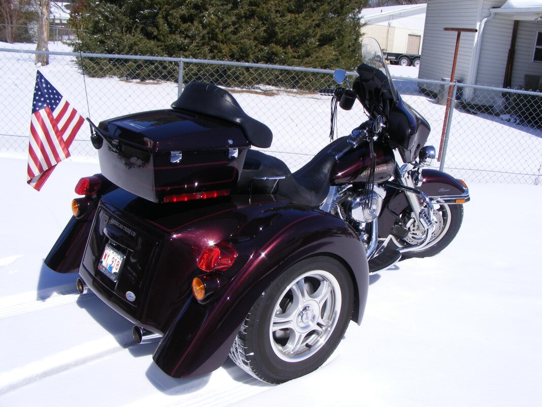

OK put a new rear tire on the front of a converted 05 Electra glide with a Champion kit; with stock exhaust converted now to true duels with a fulsac conversion kit; installed K&N filter, drilled 5 extra holes in the plastic filter housing; and today installed a V&H Fuel Pac; programmed to FP-0431 specs question is ???? anyone done this??? did you have to make adjustments to the Fuelpac ??? Right now it sounds really good ...... maybe a little rich .... but it's still cold out LOL

Nice scooter, i approve!
and yours is as well:clapping:
sparkman, That's a BEAUTIFUL Trike!!!!
ZOOM ZOOM :Trike1:
thanks...I almost got wing .... the sound is what got me ....the po-ta-to-po-ta-to-po-ta-to..... lol

If your fuel mileage goes bad and you start smelling fuel in your oil, its too rich, you can also check your plugs and look to see if they are black.
