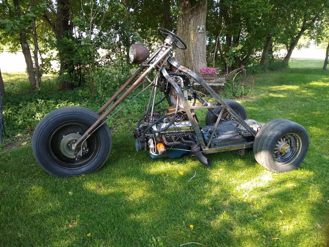

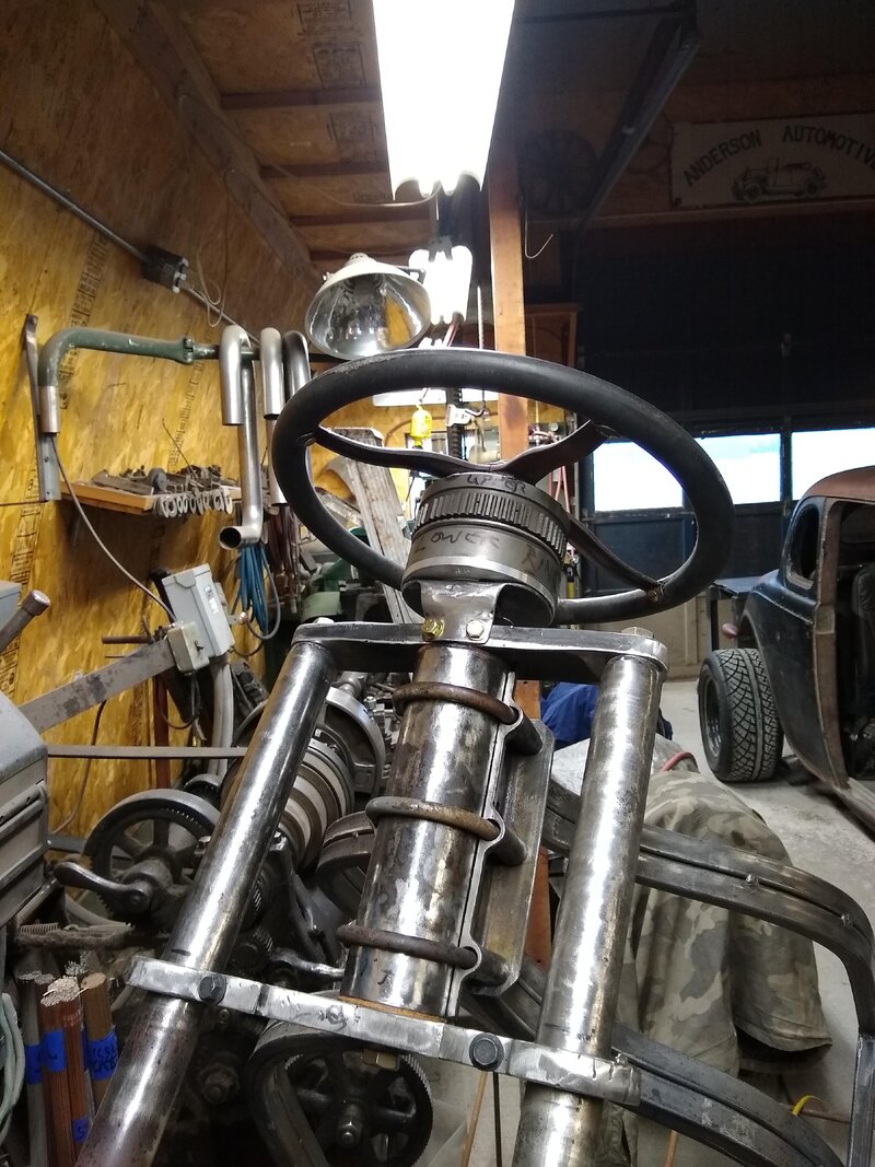

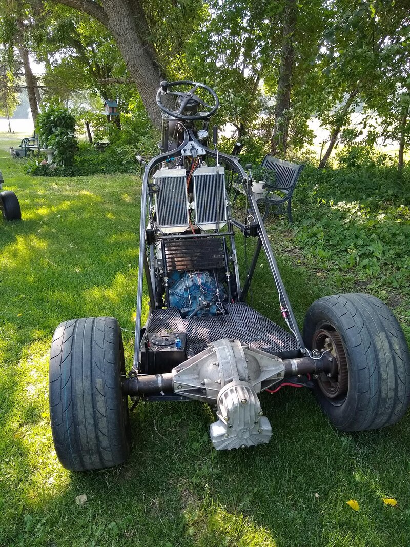

Last winters project... 289 ford v8 and velvet drive transmission from junked out boat. Old
Frankland quick change rear end narrowed. Steering wheel reduction is planetaries from a chrysler 727 automatic transmission. Just have forward, neutral and reverse No suspension so, yard use only.
Winter has showed up again so havn't got much testing done. Only 1 speed, geared low, so maybe top end of 50 mph but gets there quick.

That’s gotta be a hoot to run on grass/dirt..👍…
Keep send'n pic, I love see'n RE-builds, coming alive..........

The throttle is the twist grip mounted on the brake handle, the round handle is the f/n/rev selector and the oval handle is for slightly increasing trans line pressure to creep f/r @ idle. Opening the throttle raises line pressure and engages the forward or reverse clutch. RH single m/c is for rear drums and cross shaft actuates another m/c for the front disc. the front m/c can be actuated separately for a parking brake.Definitely in the novelty/nonsense category.
