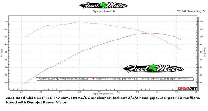

Have a 2021 Tri-Glide (V&H 4.5" Power Shots, V&H Head Pipes, Big Sucker A/C, S/E 447 Cam, Harley Pro-Street Tuner).
I am changing out the Pro-Street Tuner for the Dyno-Jet before Spring.

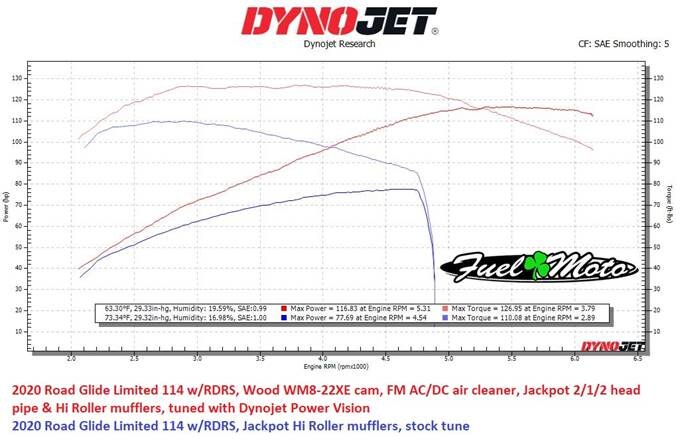

Along with the Dyno-Jet Tuner - I'm seriously considering changing the S/E 447 Torque Cam for the Wood WM8-22xe Cam.
According to Fuel Moto it will give me additional grunt over a broader RPM range.
They are also suggesting that I do Adjustable Pushrods, Lifters, the Inner Cam Shaft Bearing, and Billet Tappet Cuffs.
It all comes in their kit (tappet cuffs are extra).
Just wondering if the Wood WM8-22xe Cam is really going to give me that much of an upgrade over the S/E 447 Torque Cam.

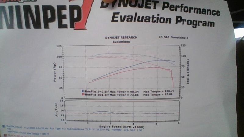

Here is the dyno sheet for my 17 with the 107 using the S&S 465 cam. With the 114 engine you would see greater numbers. I am using the Fullsac sportpipe head pipe along with a TTS tuner, i am very happy with this combo because it has great torque right off idle. Also keep in mind that a trike will show approx. 10 hp and 10 ft lbs less torque because of parasitic drag of the two back wheels.

In another post different forums, asked Jamie if the 22xe would work for a trike. His response was you could use it, but, he recommended the 22x of the rs468, stating the xe will be a little soft down low with the heavier trike. I also inquired with Sheffer performance about the cr480, response was he didn’t know as he has never done one. Also looking into the ss465 as mentioned above. Let’s face it, with the simple mods I have, the trike can hit 100 mph with some more left, but who really needs to go faster. A bit more power would be nice, especially for passing situations lol. It’s the 1800-3000 rpm range that is the concern with a heavy trike. Extra torque to get the trike moving is the key. Just an additional note, FM’s dyno sheets you need to look at what exhaust they use. A 2:1 will give you a much better curve than a 2:2.
