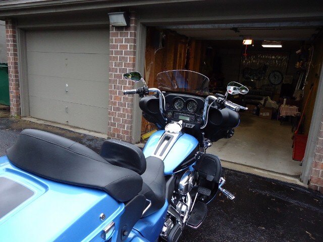

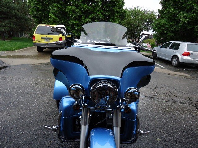

Hey Geezer , I am looking at a picture of your trike and it looks as if you have a set of raised handle bars. how high are they and did you have to got all new cables and wires to extend them to reach?
I've found that the typical MC dealer doesn't have many, if any aftermarket/custom seats at all for a customer to try. Your best bet is to be fortunate enough to find a fellow MC rider who happens to have a seat you might be interested in or simply a different custom seat for you to try. The other option would be to attend one of the big MC rally's (Honda, Harley, ect.) which usually have different seat manufacturers present so you can sample their seats. Just my opinion.
They are 13 inch Bagger Bars from Cyclesmiths. Yes, need longer clutch cable, front brake lines, and had to extend the wiring. I have a complete parts break down if you would like me to post it let me know and when I get home later I will do so.
