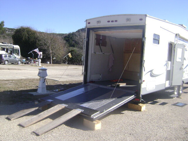

Hi,
I don't have the RS kit, mine is a Champion and it has about 3" of ground clearance. When I load it into my toy hauler 5th wheel this is what I have to do to keep the trike from dragging and the mufflers from digging in when I unload. The extra ramps are 4' long. I'm planning on attaching a hinged 5' long x 6' wide extension to the top of the ramp door that I can just flip out this spring to make it a simple process instead of carrying the three ramps.
Here's a picture of the trike and the camper set up to load / unload the trike. Hope it is helpful.

Elliott,
The runners are 48" 2 X 10 material with an aluminum lip type end on them.
Dave
Grandpa Dave has a nice setup! I do something very similar, but I don't use the center board, which gives me a little more room for the exhaust tips. I generally have to take the tongue jack all the way up, also, which makes all the difference with clearance issues.
Dave, was your photo taken at the KOA in the Ocala National Forest? They have identical RV hookups.

Elliott,
Dave
Thanks for the info. Brought my new trike home yesterday and had a little clearance problem. I may try your way, seems effective and simple enough.
Thanks again
Elliott
