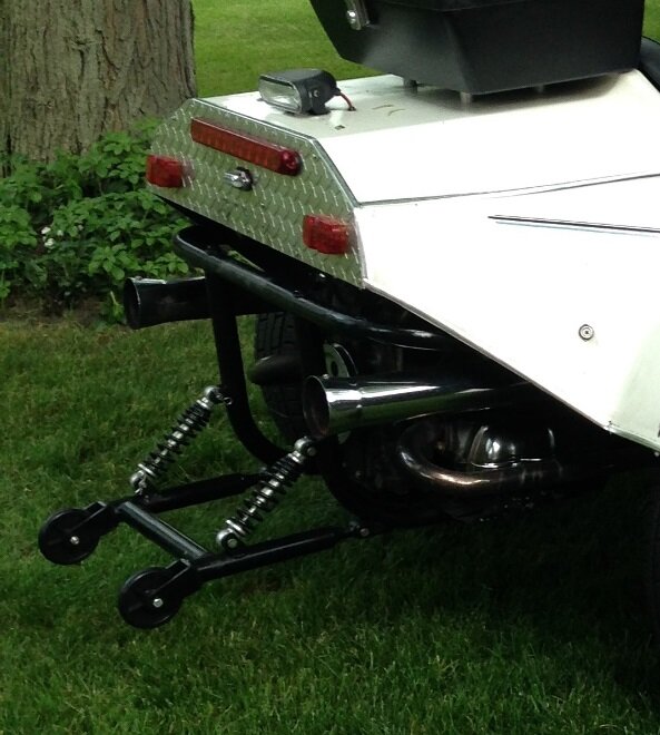

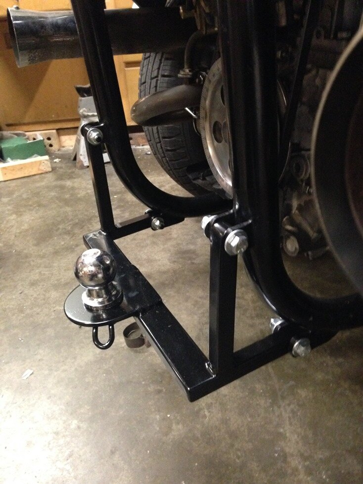

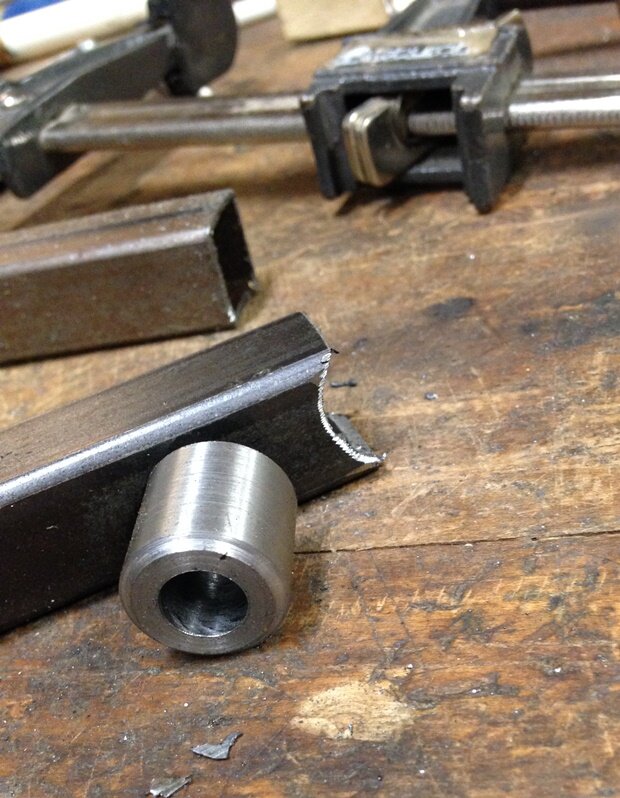

These are the wheeliebars on the back of Wilma. They bolt on to tabs that are welded to the roll cage. When I made the trailer hitch, I made it to bolt to the same tabs.wheeliebars2.jpgtrailer hitch.jpghitch pic3.jpg
i saw those on google linked to an old fleabay auction, liked them but i recall pretty pricey, im poor so have to build myself
did you design those? pretty ingenious.

Take a look at turn signal mounting clamps for Harley forks. You could substitute a heim joint for the turn signal and then put the tabs for the bolt on the wheelie bars.
I didnt design the wheelie bars pictured but I copied them to build the trailer hitch. You could use rollerblade wheels. It's just a bunch of plate and tube to cut and assemble.
