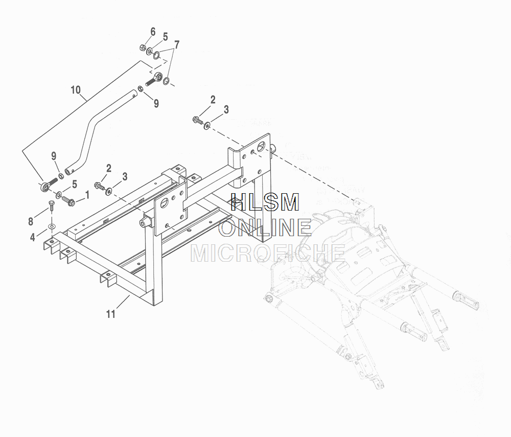

Check the panhard rod # 10 in the drawing
what do i look for on the pan head bar also what torque spects on shocks.
Shake the back of the trike with wheels on the ground, there should be no slop in the end joints on the panhard rod
The rear shock bolts calls for different specs per year of the trike
