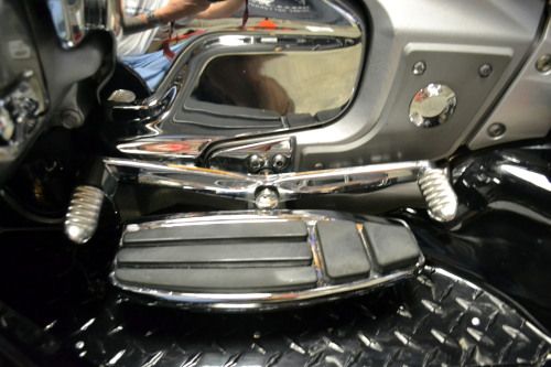

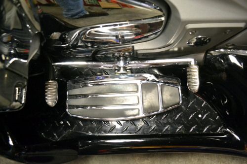

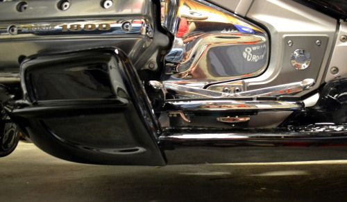

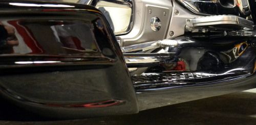

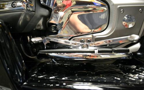

I also have the Heel/Toe shifter on my Roadsmith with no issues. And this is with the Comfort Controls also installed which brings the floor board and Heel/Toe much closer tot he Wing Boards, or as you call them, Ground Effects. I hope this helps.
See photos below;
Here are a few close-up shots of the heel-toe setup on the "HogEater".
Hope that these help!!!!!

That pic you showed, has an assembley below the heel shift peg that looks odd to me. It attaches to something-perhaps it is a specialized set up? Try removing that and it may fit and shift properly. I have never seen a contraption like that on a heel-toe shifter?<img src="images/smilies/shrug.gif" border="0" alt="" title="Shrug" class="inlineimg" /><img src="images/smilies/confused.gif" border="0" alt="" title="huh??" class="inlineimg" /><img src="images/smilies/smiley confused.gif" border="0" alt="" title="confused" class="inlineimg" />

I think Mark is referring to my photos. I have no problems shifting and she shifts smooth as silk.
What you're seeing is the setup for Roadsmith's "Comfort Controls". They move both sides (shifter & rear brake) forward and down making for a much more comfortable and to me, 'natural' foot/leg position. I never liked the 'tucked' foot position on the Wing and Valkyrie for that matter. I was all ready to go for a Harley just for the foot forward position. But when Roadsmith came out with these Comfort Controls, I ordered them even before I picked up my trike in what you would call a 'Leap of Faith' hoping that they would at least partially improve the foot placement which they did. ThumbUp
Americanbadass if you are refering to the pic that I added to the original post, the little black item is a hard teflon plastic (2 halves that are screwed together) and replace the rubber on the shift lever. The heel-toe shifter then slides onto it when installing.
