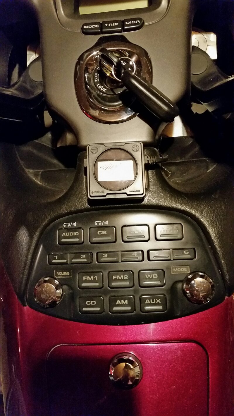

I have a few different size digital and analog meters Ive tried.
The best spot on my bike for a large depth say 2 inches deep or about has been on the right lower side black dash panel. Just below the flip open lockable door. Next to the key cylinder. My cigarette lighter is there now. If you have the radio/gps stuff on these panels your screwed somewhat.
Just make sure you don't hit the radiator support.
If using a digital thin type display.
Get the OEM Honda or similar sized gauge and mount it on the left side panel below the unlocked flipped cargo pocket. Or next to the flasher switch.
Unfortunately with the squared off handle bars not much you can do.

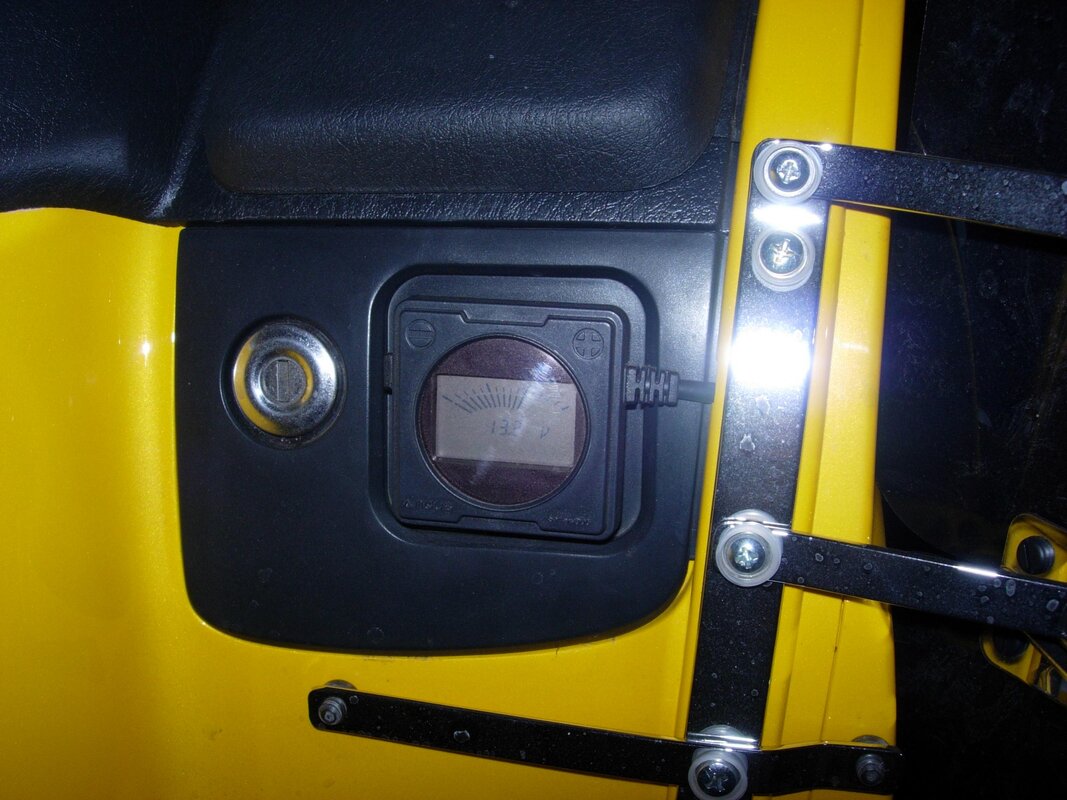

I'm leaning towards putting it next to the lock on the right as shown in the picture by sgmdudley. Thanks all.

I mounted it just below the fuel door above the radio controls on our 2004 GL1800 with industrial strength velcro. It is easy to see without looking away from the road too far. Pretty much any surface mount voltmeter would mount easily there. On that blank panel next to the lock works well for flush mount units that need some room behind the mounting surface. I used that space for a coaxial electrical port for heated gear and a few switches.
