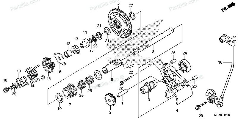

DO NOT use reverse on an 1800 as a parking brake. The reverse button is known to get stuck in the "on" position. It happens more in cold temps than hot temps. Rocking the trike back and forth will do nothing. The switch will need to be taken apart for cleaning or replacement. If the switch does get stuck, you can play with it and sometimes it will un-stick.
On another note, there is no "reverse gear" in the transmission to break. The transmission is in N and the starter motor is actually pushing the bike/trike in reverse.
Item number 5 PN 28162-MN5-000 in the picture is the revers gear, the diagram is the reverse gear parts for a GL1800.
