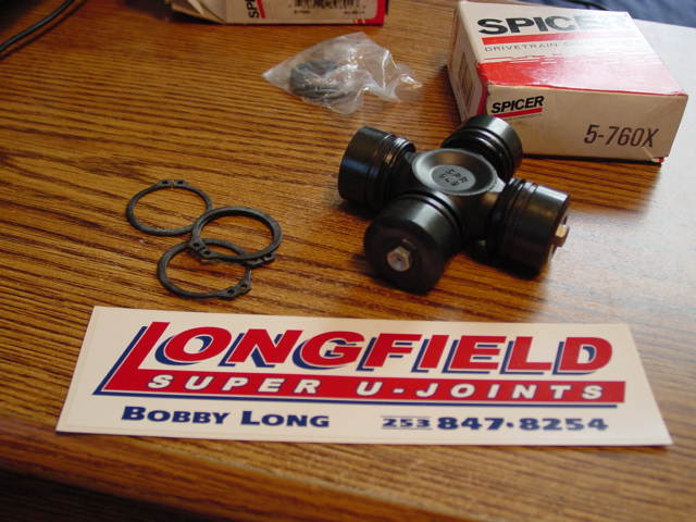

You can get u joins with fittings in the caps
like this 1 from spicer
Present day MotorTrike IRS kits do have a Zerk fitting in the end of one cap. Makes greasing the front U-Joint on '06 and newer GL1800 Trikes so much easier. I don't know if they get them that way or add the Zerk in house. :xszpv: :xszpv:
Right Gold, was up under there this afternoon, found them both, my solution to get the zerks in position, was to look under and continue to roll the machine until they both appeared in position to fit the grease gun. Not that difficult.
