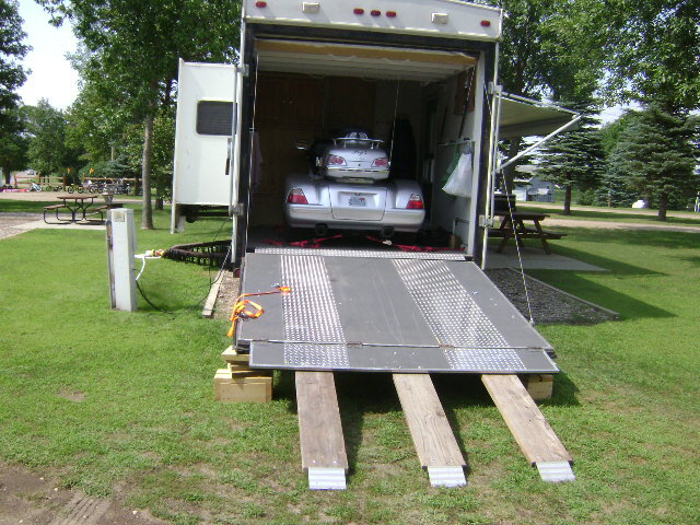

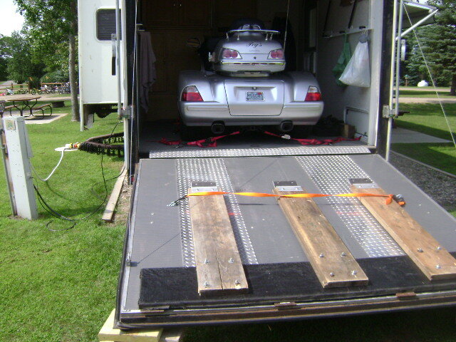

Here's a picture of what I had to do with the ramp on my 5th wheel toyhauler to load and unload the trike. The original ramp sits on about 11" of riser blocks to reduce the angle of the ramp. The three 2x10 ramps are 48" long and are bolted to the hinged flip up ramp on the toy hauler.
