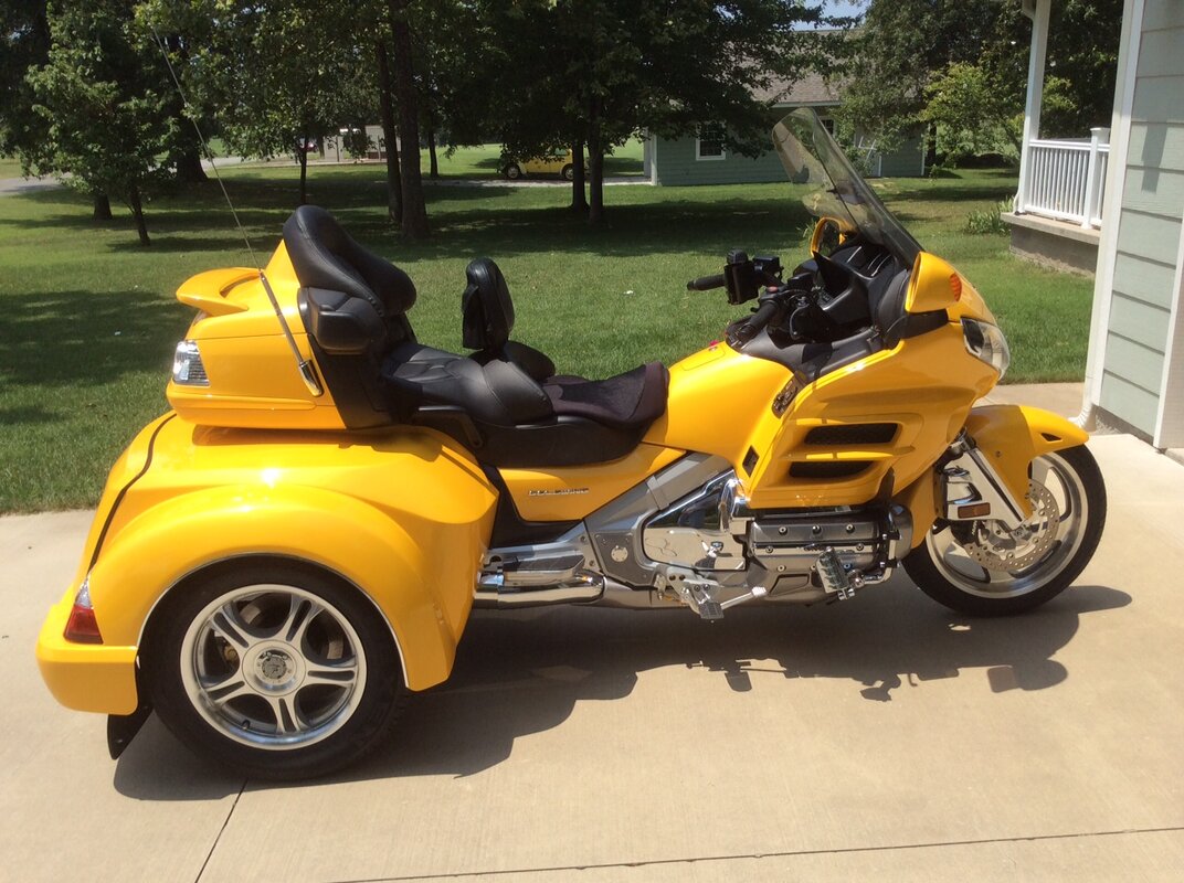

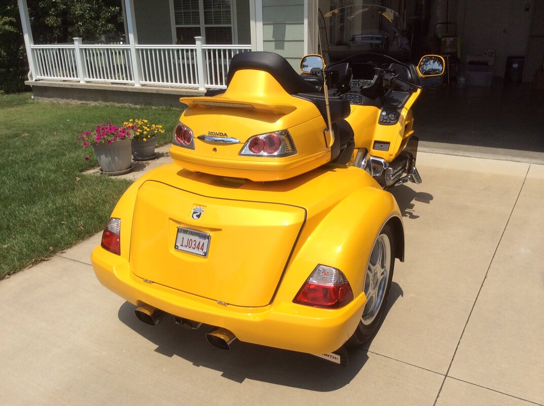

Guess I forgot to post a finished picture, I picked the trike up August 6 and haven't been able to get the grin off my face since. I have to give kuddow to Roadsmith's painter, the finish is absolutely perfect, not a blemish anywhere. The 75 mile ride home was a get acquainted experience, still taking some getting used to the feel in the curves, haven't figures where I should set the progressive shocks or the adjustable pre load to get the best feel in the curves. My wife took her first ever motorcycle ride with me last Saturday, I think she is already hooked, heard her talking to a friend about buying riding gear. The installer did a great job as far as I can tell, only thing I discovered and don't know if I should jump the dealer about, they charged me $325 for tail light bases, bulbs and sockets and then used the tail lights from my saddlebags. Here's the finished product.
I would certainly ask somebody why they charged me $325 to use my own parts and they better have a real good answer.
BTW that is a really pretty trike and I am not a real fan of Yellow,but that is nice.
Every time I stop somewhere someone comes over to admire my trike, the yellow certainly catches your eye. Yesterday I stopped to fuel up and two old fishermen were fueling their bass boat and they both came over to ask about it, of course I had to brag a bit.
