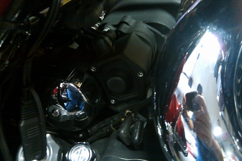

The pigtail is usually located on the left side (clutch side). All Harleys come with a pigtail...used for a battery tender and/or heat gear...from the factory. It may be "stuffed" under part of the frame near the battery. Did you take a real close look at the battery connections with a flashlight? There will be an added connector on each pos and neg post. There would be no reason for someone to take off the pigtail....did you buy from a dealer or private party? I have my pigtail exposed on the left side/top of seat for easy access for battery tender and heat gear.
It can be hard to find the 1st time, some people try and hide it tucked under the seat etc. I will bet it's there, mine is on the right side, you need to take a look at the plug in on the charger so you will know to look for, if all else fails, swing by any Harley dealer or someone who owns a Harley or most any motorcycle, I'm sure they will be glad to show you.

Your dealer took a short cut on setup, they have piles of those pig tails laying around. As part of the setup they install the pig tail for the battery tender, which is one of the reasons folks find them in all kinds of different places. The tech installing the pig tail can put it any place he chooses, some try and hide it and others put it in plain site.
I had trouble locating mine at first too and thought it wasn't there. I called the dealer and they assured me it is there. Before my wife accused me (like she always does) of looking for something with my eyes closed, I looked harder and sure enough, there it was.
