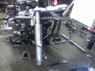

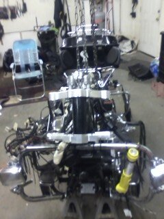

These are high quality +5 degree raked triple trees that I installed myself. They had easy to understand instructions and if you can read and are some handy with tools you can do the job yourself. The instructions include all the torque values on screws and fasteners and I suggest you pay attention to them. Otherwise its Pretty hard to screw the installation of these trees up!
The forks screw into the upper tree hand tight ( throw away your pipe wrench) and eliminates the need to assure evenness in an upper triple tree pinch clamp that are standard on Harleys. They come with a 2" fork extension that screws into the top of the forks and upper tree. They also include high quality neoprene bushings for the the handle bar mounts.
The bottom trees are a pinch type set up, easy to use. The very bottom of the shaft has a 3/8" ratchet hole to set the bearing pre- load and also accommodates the brake line mounting screw.
The top nut is easily torqued and locked with a bendable tab, There is nothing cheap about these polished finish trees, They would look good even exposed to the eye.
They are pre drilled to accept the lower air deflector and come with mounting hardware to accept all fairing mounts, in other words it is a complete set up. If you have air assist on your front end be sure to order the air kit fittings they are sold separate.
Mine is old enough to still have the anti dive system and I was able to adapt and utilize the system. Most trike builders eliminate the anti dive as a matter of ( I don't know? Laziness?) There is an advantage to doing something yourself.
for pics of my build google pcombe library/photobucket
Click on the pictures and I will give some real good info on how to do things like remove the bottom bearing race etc.
As always I recommend you have the motor manual on hand for reference.
I would recommend these trees to anyone at any time and feel real confident I did you a favor.
