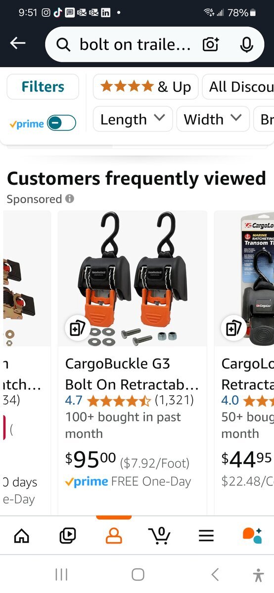

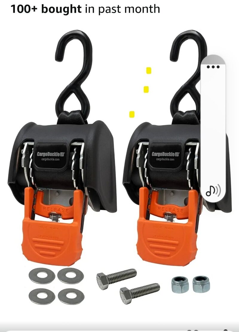

As for my tie down preference, I personally have used the 2" Cargo Buckle brand, (bolt-on the trailer) rachet straps as my go-to system.. They are the quickest, most secure and consistant method Ive used to secure mine or my customer's trikes on all three of my trailers. Two are the Ultimate Trailer brand air ride teardrop enclosed drive-on trailers and one is my heavy duty 24ft steel open trailer. These straps are very well made and will last for many years.
I use one set of 2 for the rear and one set of two for the front (one per side on the crash bars). I also use a quality drive on K&L or similar wheel chock for the front wheel. Actually, Harbor Freight makes a decent wheel chock, don't remember the model, but its not their cheapest one. I will check that and revise.
