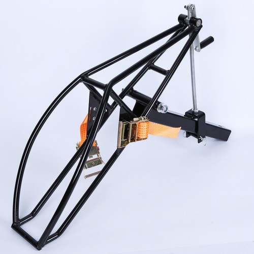

Wondering if anyone has an experience towing a trike with one of the receiver mounted devices that the front wheel mounts in?
Because I have to make a trip and will need the car for part of it and the trike for the second part...also would make it a lot easier to get it to the shop when needed...

Truthfully i would advise against it...With a light dirt bike that gets beat up in the dirt anyway maybe ....But with a Trike...?
I have a similar tow hitch from a different manufacturer. However it's not something I'd use on a long haul, as it supposedly puts non typical strain on the frame neck in cornering.
I've used it for towing once, a distance less than 50 miles and it didn't seem to hurt the frame or any other component.

read your manual it will tell you towing without disconecting your belt drive will trash the tranny

Thinking about that too...Would be easier and quicker to get the trike to the shop if riding it's not possible. I have discussed the towing with several mechanics and only a couple thought it would cause damage. Most agreed that if the tranny is in neutral and the front wheel in secured in the cradle, shouldn't be any damage to the trike. I am still looking for one, but like the ones that don't require a ramp.
Tongue weight would be light on that hitch/tow bar but I'd be concerned about front to back shock loads on the hitch and frame/forks when trike wheels catch a pot hole, etc. Probably not a problem for short (emergency) tows but I'd be leery of cross country tows.
